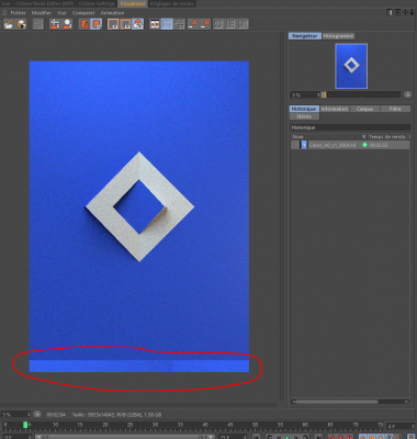

I've got an issue here when I try to render a simple scene on a big resolution. I need to export for printing on A0 300dpi (9933x14043) and I've got some strange issues. I've already rendered successfuly this scene on a A2 size.
Please take a look at the attached file, you'll see a big artefact on the bottom of the frame (sometimes I got different results on this area).
First I was getting an error message, I saw in another topic to decrease the parallel sampes to 1 and indeed it's help me to render the frame without crashing. Now I always got this artefact on this area. Anyone can help me ?
thanks

Hi Darkpulse,
I suspect that you have not enough memory for this resolution.
Do you have the post effect active? If yes, disable it, you should reduce VRAM quite a bit at this resolution.
Have you tried with Out-of core active?
ciao beppe

bepeg4d wrote:Hi Darkpulse,
ciao beppe
No, post effect is disable. Out of core seems to be enabled by default.
I have two GTX1080 so VRAM should be ok, isn'it ?

Posts: 10611
Hi Darkpulse,
please, coud you try with the latest plugin version?
viewtopic.php?f=85&t=59657
There is a change in frame buffer in the latest SDK.
What is the amount of RAM of your system?
ciao beppe

hi again,
Same results with this new build. I have 64GB of RAM installed here.

Hi Darkpulse,
do you mind to export to Standalone and try to see if you have the same behavior?
Or could you privately share your scene with us for further investigation?
ciao beppe

The artefact is not visible with the standalone. Would you like the project file anyway ?

Hi Darkpulse,
do you mind to privately share the scene with us, so we can better investigate the issue?
ciao beppe
