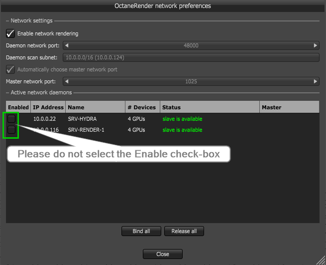

Hi Jo,
Apology for the late response. Can you please make sure if the "Enable" option in OctaneRender network preferences dialog is ticked?
Also, the version of Octane Daemon Slaves must be same with Master.
Please let us know how it went.
Cheers
Cheers
