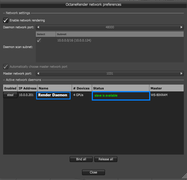

Apology for the late response. Can you please make sure if the "Enable" option in OctaneRender network preferences dialog is ticked?
Also, the version of Octane Daemon Slaves must be same with Master.

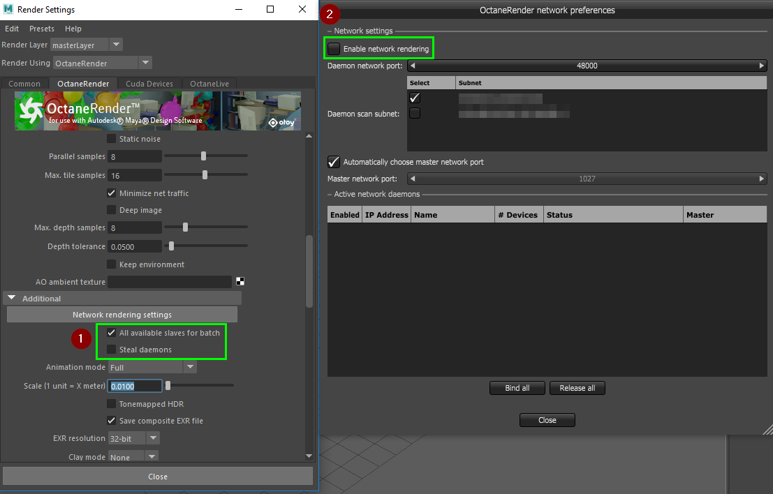

Just an update on this network batch rendering issue. Would you please run a test with our latest build v3.06.4 - 11.7[STABLE] and let us know how it went?
1. Select "all available slaves for batch" also "Steal daemons" can be enabled if no one is using the render server.
2. Then, make sure to uncheck the "Enable Network rendering" from the Octane render network preferences.
The "Enable network rendering" is now used for IPR render only. So, basically by disabling it, the slave daemons are made available for batch render.

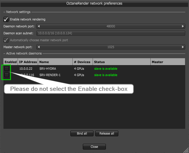

Are you able to see the Slave daemon from the "OctaneRender network preference" dialog?
Please check the version of the Slave daemon matches with the plugin version.
Here is the correct Slave daemon link to download [ viewtopic.php?f=24&t=61815 ]
After installing the Slave daemon, please make sure to enable the internal firewall.
