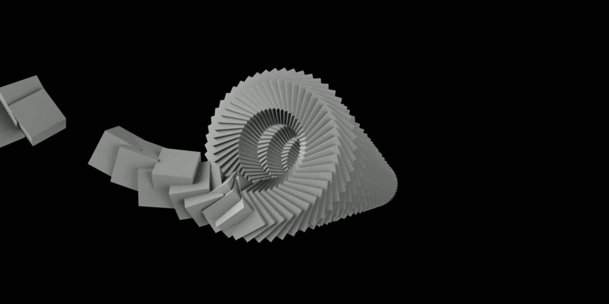

This is the result of an f9 render for me:
Any ideas?
Thanks,
James.
