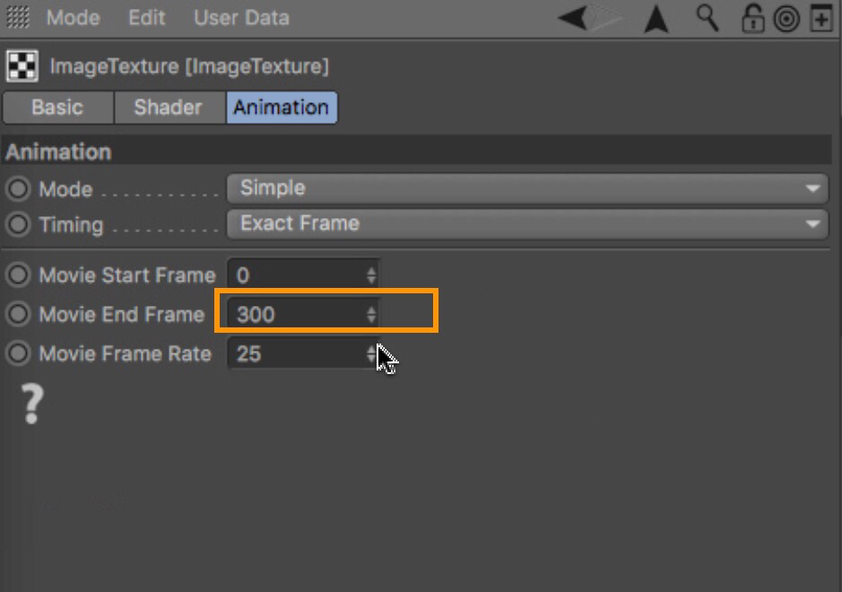

Hi noisyboyuk,
it seems that you have forgot to set the lenght of the sequence: after that, it works as expected in Picture Viewer.
ciao beppe

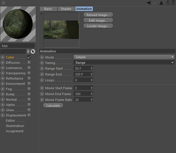

I apologise, I must have forgotten to save it with the frame length set but I have been setting it in my tests. In fact just to be sure I just went back in and set it but I am still getting the same behaviour. One thing I would mention is that when I set it up myself, I set it to "Frame Range", rather than "Exact Frame" so I can set it to start at frame 50 (which is where the camera tracking data starts from the Nuke export).
These settings should be correct as it works fine if I render with C4D's Renderer instead of Octane.
Just for clarity, the issue isn't getting it to play. The problem is that if you render the sequence out to the picture viewer and play it back, the projected material on the plane appears to float around rather than match up perfectly with what you can see on the Background object. If on your end it seems to be working fine, would you mind sending the project file back to me so I can check it out at all?
