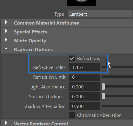

The material convert command now works but the conversion from Maya materials is very wrong !
Maya transparency is converted to octane opacity as is, but opacity is the inverse of transparency !!
As a result opaque Maya Materials are converted to completely transparent Octane Materials :?
Also previously when a Maya material had transparency it was converted to Octane specular material,
now Maya material are never converted to specular only diffuse and glossy,
maya transparency was the only way to get specular materials...
So logicaly transparency should be translated to invert opacity
but people are never expecting opacity from a converter,
they need refraction !!! so basicaly acting as previous version of the converter convert to specular when transparency is not black,
or maybe convert to specular material only when refraction is enabled? (and getting IOR at the same time )
But to be honnest I think most user needing to convert Maya material to Octane Materials are people importing geometry and Materials from other software trough FBX.
FBX don't import refraction setting but use maya transparency attribute to fake the refraction.
So the way the converter was working before was a better match (convert Maya materials with transparency to octane specular),
also is missing the convertion for file textures plugged in other attributes than the base color !!
