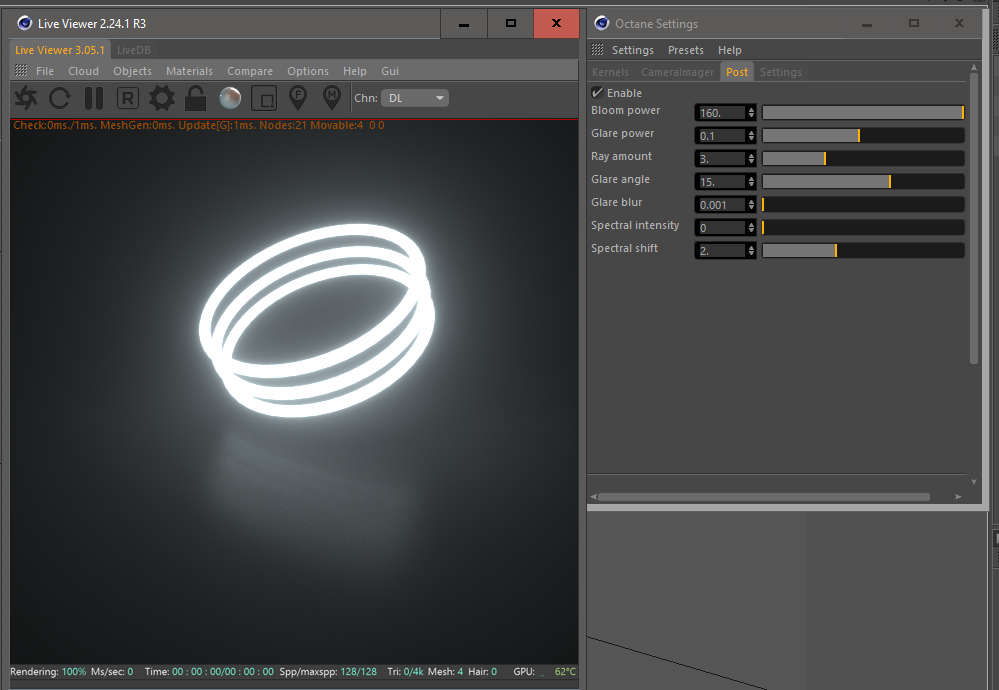

Is this what you are talking about?

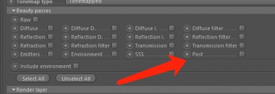

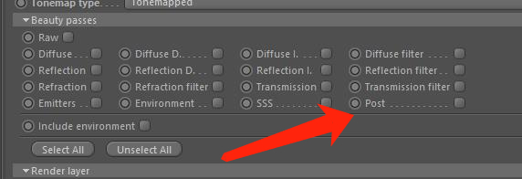

and you can render it as a separate image using "post" seting in Render Passes.
This will give you the ability to control the strength of the glow in post.
