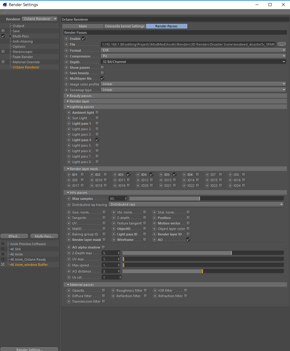

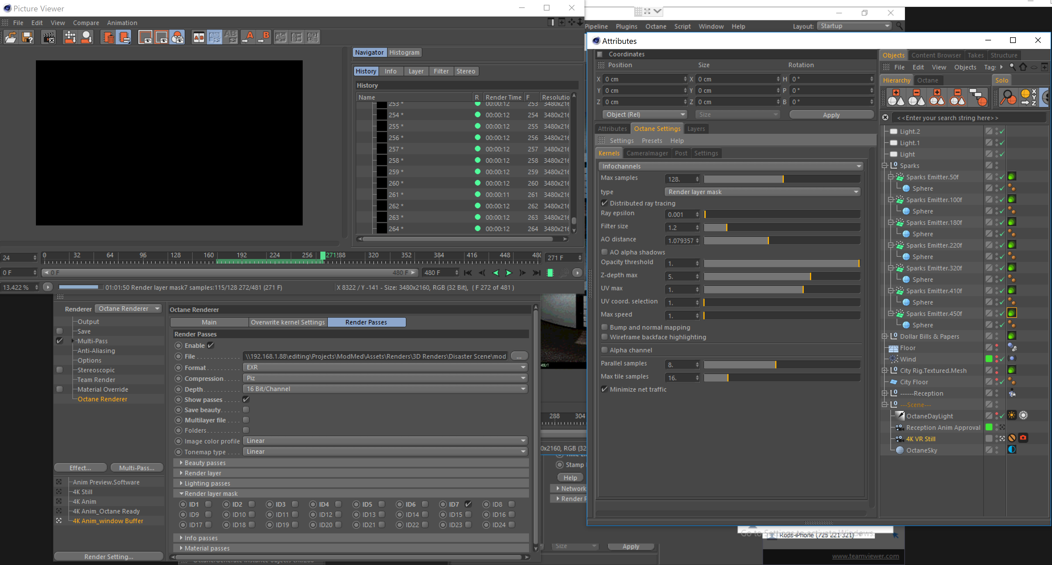

I'm trying to do the same thing with Octane. I need only one Layer Mask and that's it. The main render I already have, just need to re-render that layer mask. I selected the Infochannels Kernel, and only selected the one ID that I need.
This should render super fast, and I am talking aobut 0.5-1 second per frame, but still it takes 10+ seconds per frame.
Granted, I am rendering 4K but still, doesn't make sense that it would take this long for just an info channel.

Normal scene render at 2500 samples is about 7 minutes. I did notice that on the very first frame it takes about 3 minutes to analyze all the frames, and then on each frame it takes about 2/3 or render time per frame "preparing"... I still feel like this process should be faster though. I am not asking the Kernel to read data for materials or textures, just one simple layer mask.aoktar wrote:You should check times! How much is about pure render process and scene data preparation. Second cannot be avoidable for normal renders or object masks.
even so, most of the time in my timeline right now, the mas should be black, since my object only becomes visible for about 15 frames and invisible for more than 30 frames, but still is taking the same time on the frames that is visible vs the invisible frames.

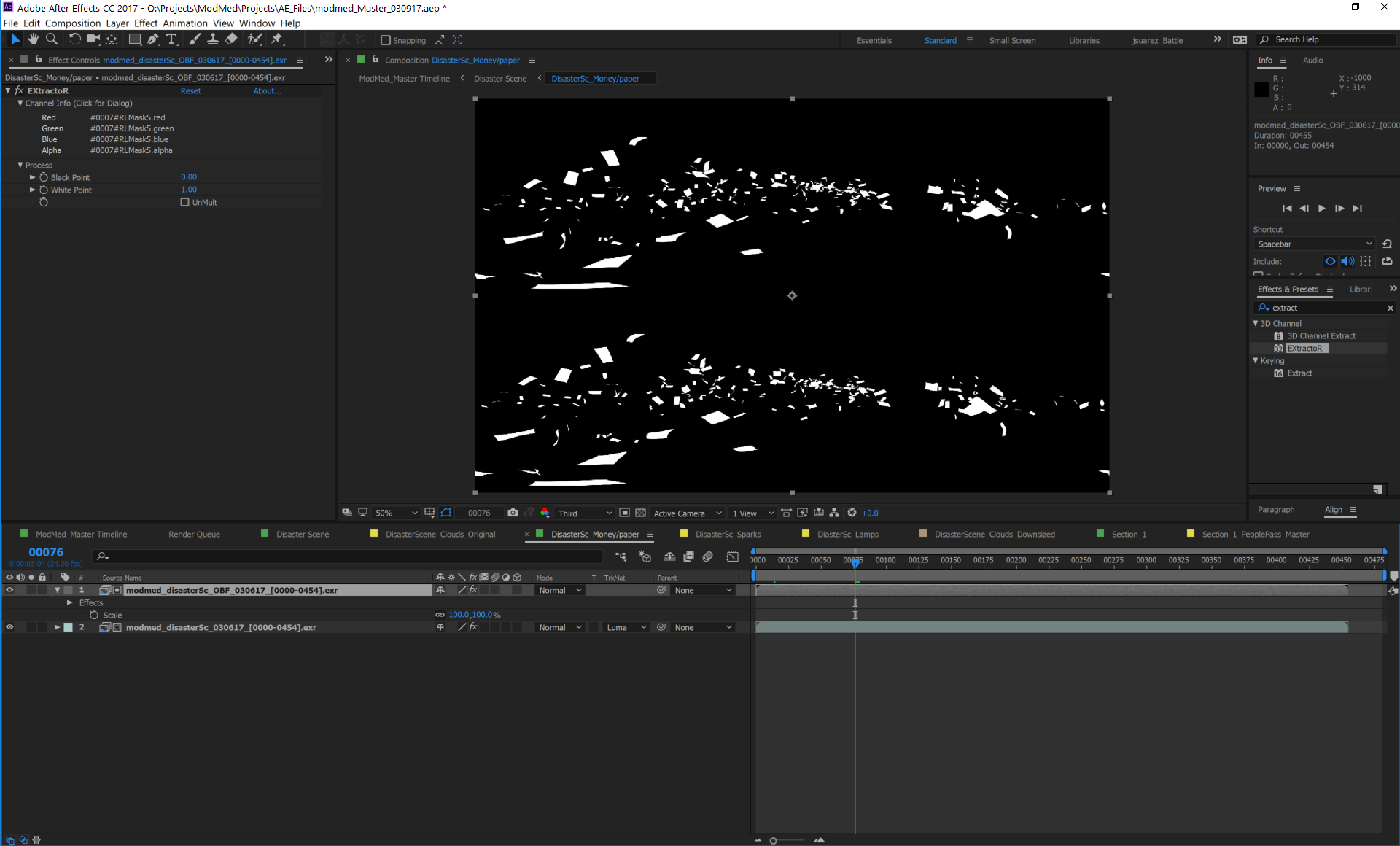

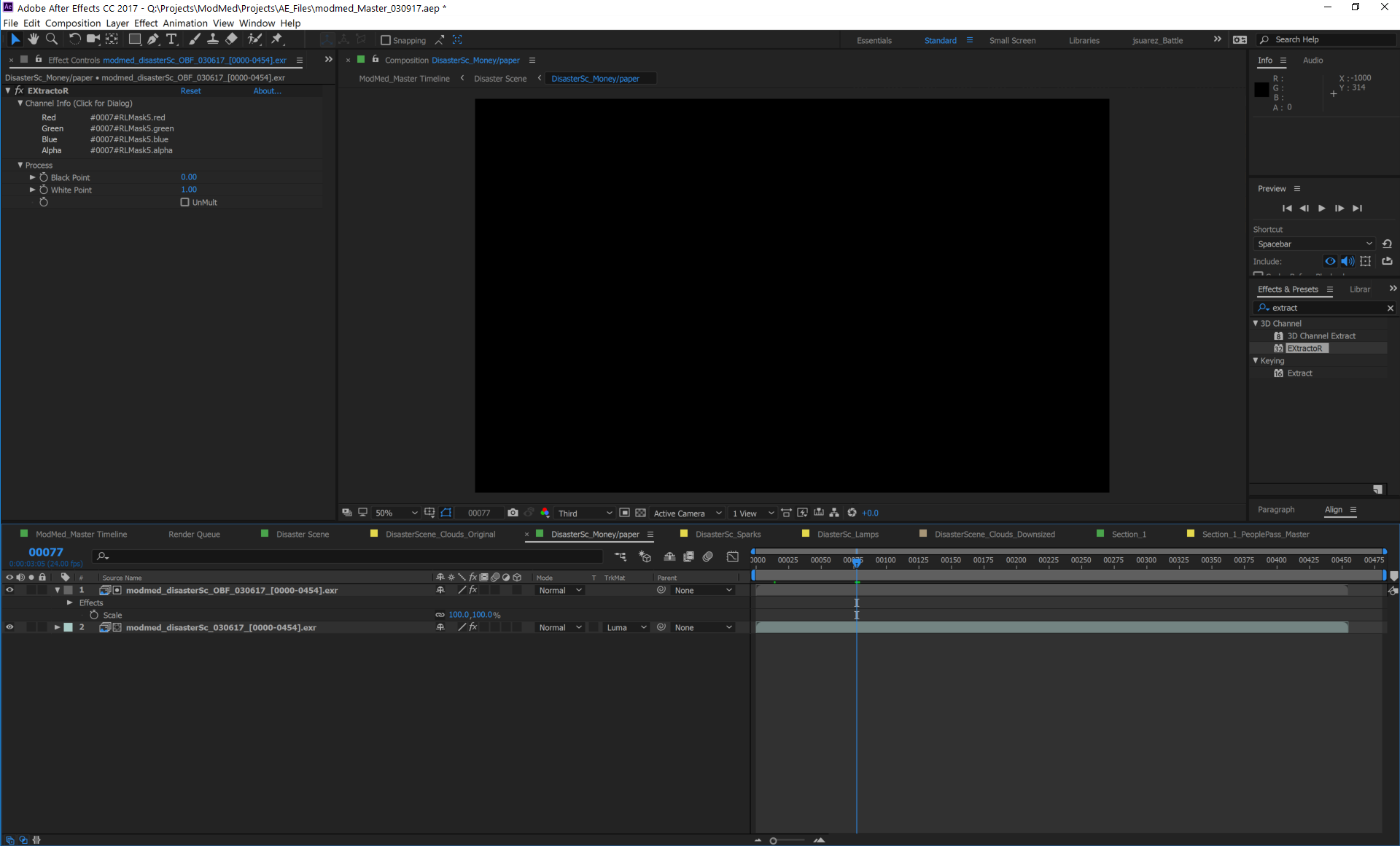

I am having another issue. I have set up a Multi Layer EXR with my main render. This I had already rendered a few days ago and all layers were working fine, but now I just realized that after 80 frames, my info passes dissapear, and all I get is a black screen.
Main EXR render is intact though, no problems with that, only with the info passes. Does this make sense? Have you had this problem before?
I know it's not a problem with my scene, since I thought there was an issue with it, I rendered one of the Layer Masks in a separate EXR and it worked just fine, the issue is with a Multilayer EXR.
