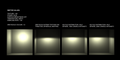

I would like to clarify some things about IES light intensity in Octane, it would be really appreciated if an Octane developer could comment. From my own tests, IES files plugged into the 'distribution' node of an emitter seem to normalize the candela values listed in the IES file to a range of 0.0 to 1.0. It makes no difference if the values listed in the distribution web, or the overall multiplier field, are 1, 1000, or 2000. In the rendering below, each box has the same geometry, the same emitter sphere (with general visibility set to 0), and the same material and emitter node, only distribution differs. Do I have this right? If so, then doing accurate lighting would require reading the lights maximum intensity from the IES file (in candelas), and entering that as the emitter's power.
Another question is about the units Octane uses for light intensity. The documentation for mesh emitters lists the power node a 'the wattage of the light source'. I think this should be actually be the radiant intensity of the light source, measured in watts per steradian. If it were actually just watts, then a light with a half-sphere distribution would necessarily have twice the intensity of a full sphere, but the test renders show the same level of illumination on the test boxes. Checking 'surface brightness' has no effect on this behavior.

I guess you are missing a very important value for translating lights in OctaneRender, that is the Texture value:
Texture
This setting is used to set the efficiency of the light source. No light is 100% efficient at delivering the power at the specified wattage (a 100 watt light bulb does not actually deliver 100 watts of light.) The efficiency setting can be used to enter the real world values.
These values can be used to create very realistic light settings. For example, a standard 100 watt incandescent bulb would only be approximately 2.0% efficient where as a 25 watt compact fluorescent light will be 10% efficient. These will both produce around the same quantity of light in real life.
In the past it was named Efficency/Texture (probably a bit less confused), and the default value of 0.025 refers to the standard filament emission.
You have to correct this value along with the Watt power to mimic real life lights:
https://en.m.wikipedia.org/wiki/Luminous_efficacy
ciao beppe

Thanks bepeg4d, I also found your other post on using 1/683 to work with Lumen instead of Watt, that's very helpful. Hopefully Octane 3.1 will have a better implementation for IES / Elumdat files.
