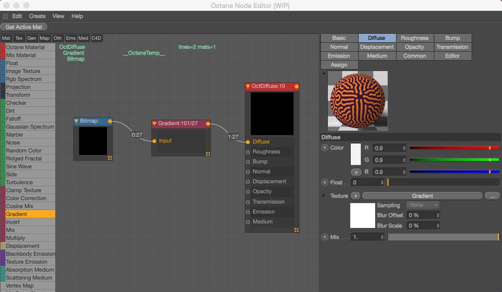

The render comes out different in the viewer than the final render.
Here is a screenshot of the Material, this material has a movie texture compressed in photo - jpeg quicktime format.
Thanks in advance.

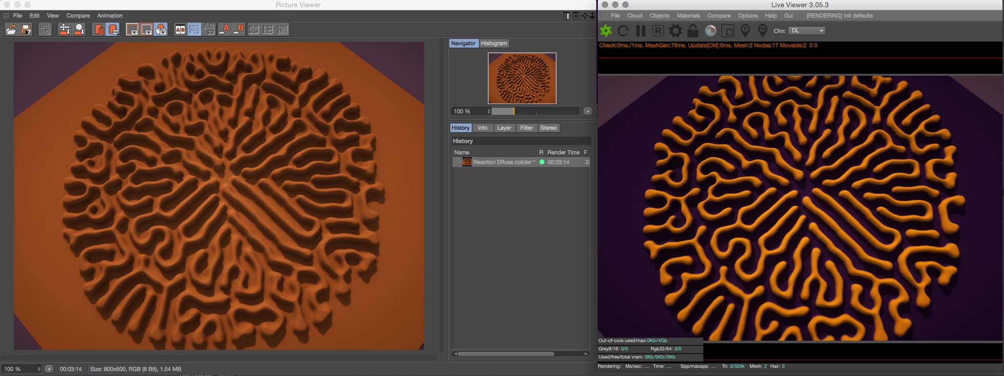

Here is a sample, it looks like the animated texture that I use to drive the gradient only works on the live viewer.
Thanks.
Posts: 10623
Hi DieGolum
if you are using movie textures, they are not supported, you need to use image sequences.
