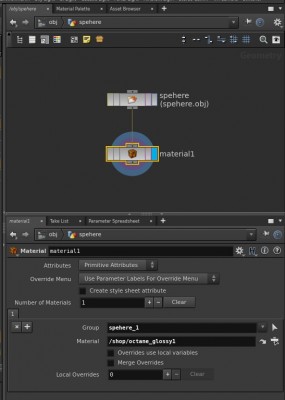

I'm hitting a weird issue with some geometry objects I've created by .obj files imported from AgiSoft PhotoScan: they remain purple when rendered in OctaneRender (i.e. assigning the material appears to be failing?). The same geometry (although it is not clean by any means, it is a really bad quality scan in fact with holes) does not appear to have any issue when rendering with Mantra.

To assign materials to objects from .obj files you need to use the Material SOP node. The .obj files are imported using geometry groups, that currently must be configured using the Material SOP in the Octane plugin.
