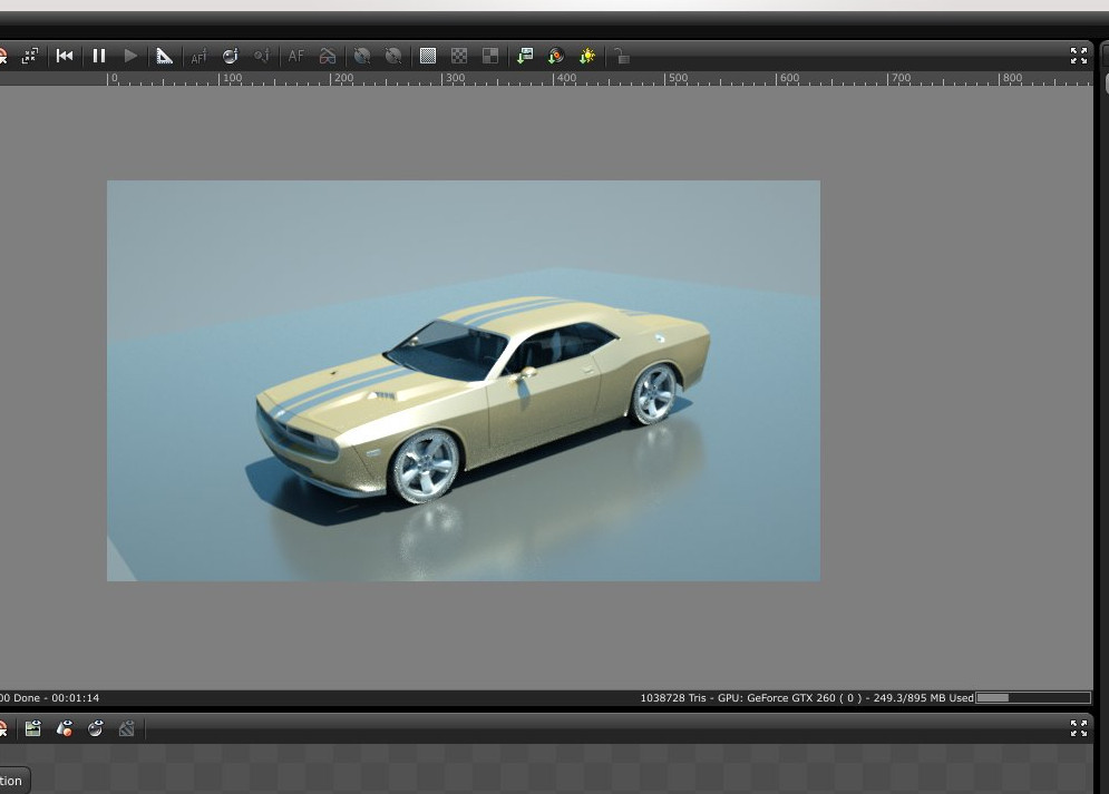

Hey guys,
i downloaded some blend files from blendswap. There are some great cars on that site but octane
won't open when i try to render these. Are these projects to large or rather to advanced?
Octane doesn't open advanced projects

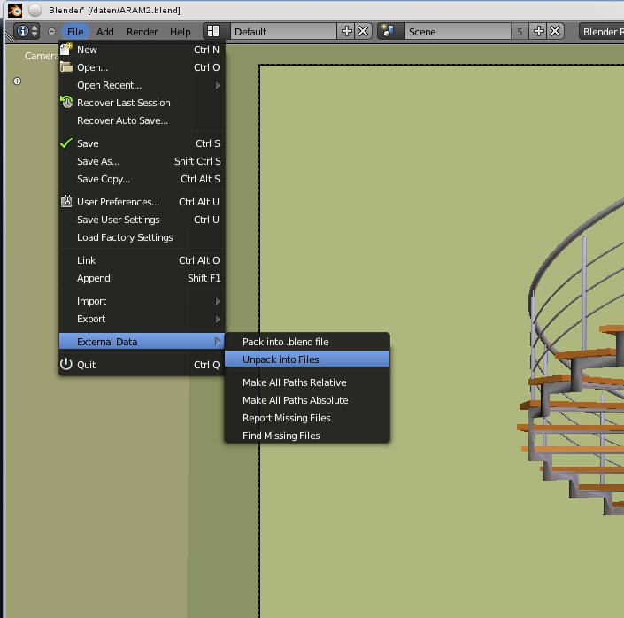

I use latest svn build and exporter 1.10.
I had to unpack the textures into files and set absolute path in blender settings because the exporter stops if it not find textures.
It takes 250 MB vram, so not a problem with your card.
Cheers mib
Cheers mib

Thank you mib it works right now but i had to remove the textures. How did you do it?
You said you set a relative path to the textures? how can i do this when they are packed
into the blend file?
