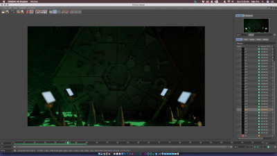

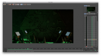

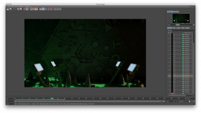

Hey, folks. I have a scene that has no animation, but camera animation and some pulsing lights (blackbody textures). It's a pretty simple scene, and all of these pulsating lights, though not moving, have octane object tags on them just to be sure. I have also, for saving time during the export phase of each frame, have it set to manual object update. Anyhow, things were moving along for a while at about 10 minutes a frame, which is reasonable considering I just have one GTX 980 ti. But eventually I noticed the render times jumping between three general lengths of time though the information the screen is roughly the same. They go from 9-10 minutes, to one frame that is 21 minutes to render, back down to 9-10 minutes, and finally have plateaud at a whopping 37 minutes a frame. I've got some included images and you can see on the right the corresponding render time for each of these images. I am really curious what could cause this arbitrary jump to this render time, is my GPU overheating after frame 25?

Actually I had a similar thing. I had a scene where I had some lights turn on at some point. I used animated Power parameter for this. The frames where the lights were dark rendered significantly longer than when they were at their full power. It was before adaptive sampling was available so it didnt have anything to do with noise levels.
It's not a plugin problem though, but the render engine. Probably something involving importance sampling between light sources gets messed up when there are dim lights.

Wow, Bartolos, I think you're on to something. I checked out the sampling rate of this blackbody material that makes up all of the lights in the scene, and I must have, when experimenting with noise reduction cranked it up there when there was just a single on of the lights. So, basically I have like 16 lights all with a sampling rate of 1000, also reaching a power of 200 at the peak of the pulse. I will reduce these rates and see what I get. Thanks for the suggestion!
