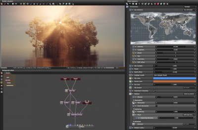

sorry I don't have a direct example in Maya, but please look at this screenshot from Standalone :
viewtopic.php?f=23&t=54581&p=278036&hil ... ys#p278036
Firstly you have to use the Scattering mebium node, not the volume node. Then you have to correctly set the Medium radius/Thikness expressed in meter, and based on the dimensions of your scene. Finally play with the Phase value to have a more or less scattered effect.

Hi sachakogel123,
ops, sorry, here is the image:
Another solution is to use a geometry with special specular material with index 1 and medium node with the same settings as the Environment medium node, but the camera cannot be inside the geometry, or to use a VDB volume as explained here:
https://docs.otoy.com/manuals/products/ ... og-system/
