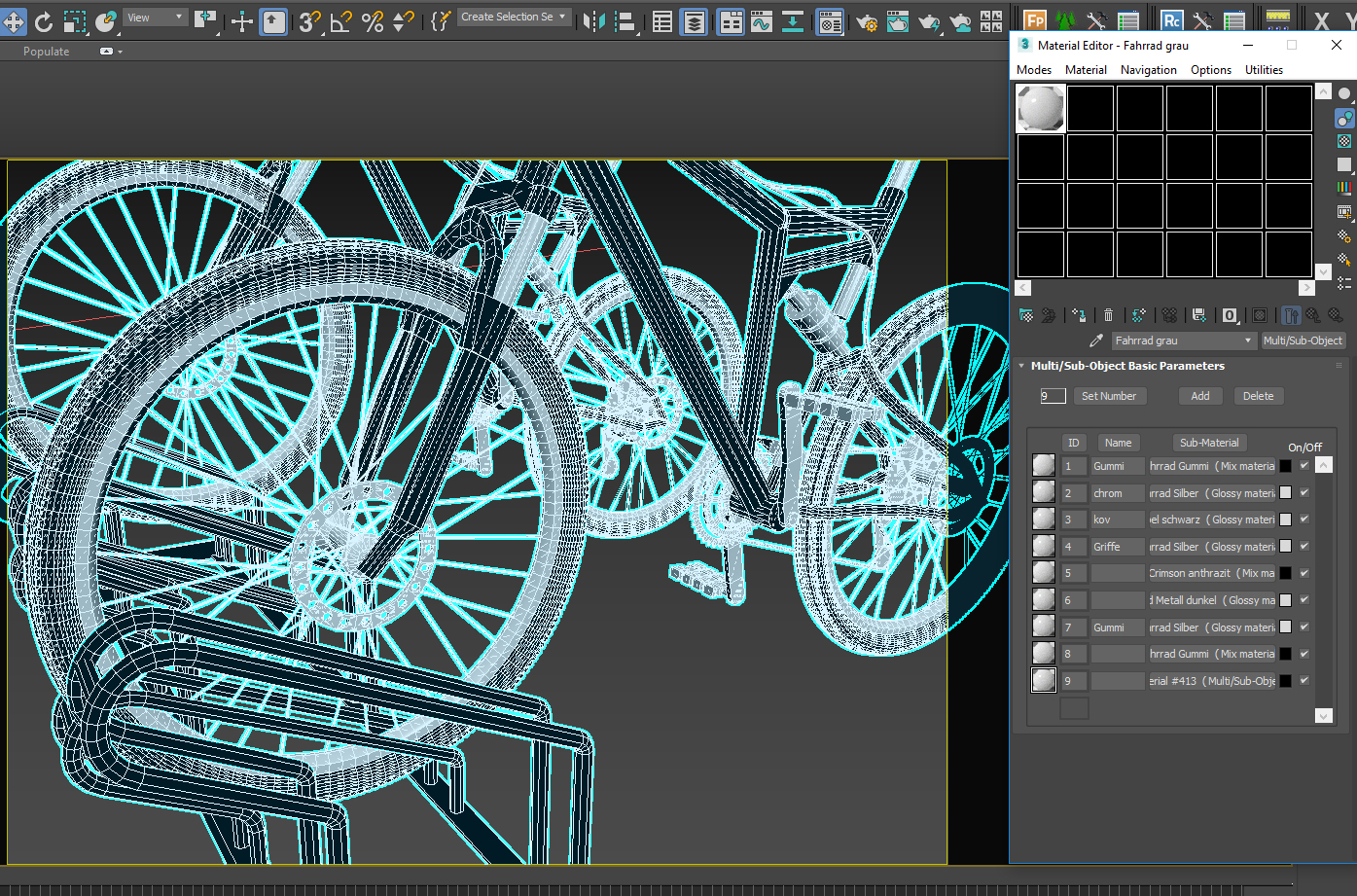

Working a bit in a project with the V3 version, I noticed that there are more conversion issues not related to opacity maps.
Some materials just aren't converted at all but turn out into simple white glossy materials. They lost all their connected maps. I'm not sure right now wheter this is related only to multi materials or also single materials.
That's a huuuuge problem for me right now, because I cannot import and convert my old material libraries. Doe anyone know what to do? :shock: :shock: :shock:
paride4331
Posts: 3991
Hi Philipp1980,
could you kindly share your Multimat in a scene test before you convert it?
Regards
Paride
Philipp1980
Posts: 68
Joined: Thu Dec 15, 2011 9:56 am
Hi Paride and Octane Team,
after doing some tests I believe that I've found out the following:
When I open an old scene (V2) with the conversion enabled, it's working fine except the above mentioned bug with the opacity maps of the plants. BUT if I want to merge an object from an old scene into a V3-scene, the converter simply does nothing. Thus I have to open the old scene, let it convert the materials completely, save it and afterwards I can import one of the old objects into the new scene.
Workflow = 0 :cry:
Can you reproduce the error? I think sending you the scene won't help...
Greetings & thanks for your help in advance... :)

[quote="Philipp1980"]
Sending scenes helps always, do not be lazy
Philipp1980
Posts: 68
Hey Elvis,
first of all: not lazy but working 24/7 on several projects… cauz it’s also a question of licenses with the 3d objects, I’d have to prepare a scene, which I can do when I have a bit time to breathe again :).
Plus, as I stated in my former post, I already figured out the problem. I still think it doesn’t really help sending the scene, because the problem has nothing to do with this special scene, object or material.
The problem is related to the workflow. Importing the Octane V2-object into an Octane V3 scene didn’t work --> material hasn’t been converted. But converting the whole V2 scene first and then importing the same object with the same material afterwards worked.
Can you reproduce that?
Greetings
