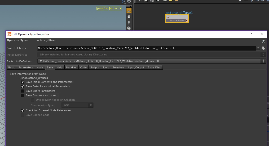

Just one little remark : I constantly "allow editing of contents" on pretty much all octane shaders, maybe they should be an option to make it default ?

You can modify this behavior yourself. You only need to edit the HDAs type properties, disabling the "Save Contents as Locked" option. The problem is that if you update the plugin, replacing the HDAs, you are going to need to do it again.

Oh ok, these are otls of course !
