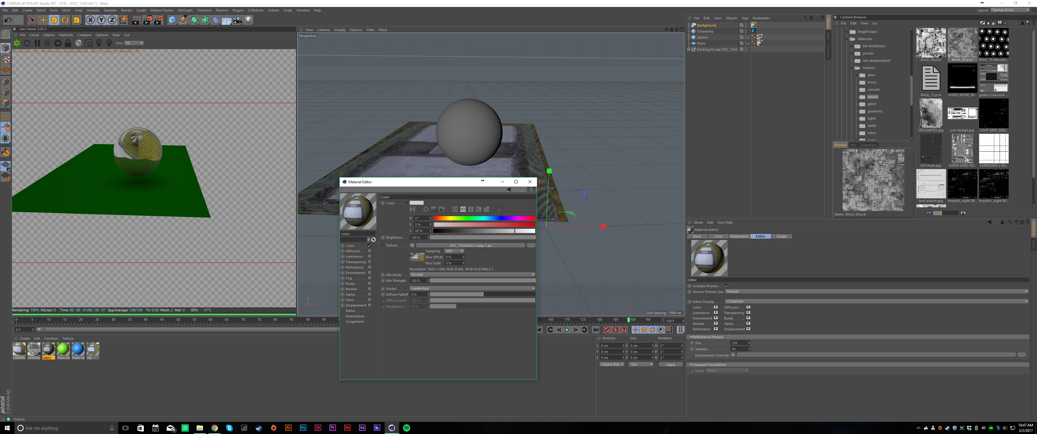

many thanks for the scene file. what i understood was that you were in directlighting while i was using pathtracing. is there a way to do this with pathtracing aswell? so i switch to directlighting still no result, i am using a video file in my material as a animated background, this will not show in the octane preview. i tried with gradiants and still images and those worked finr. i guess my final question is : is it possible to make this work with animated elements such as a video in my background? ive linked a screenshot of my project below to better illustrate my question.
Posts: 16068
Location: Türkiye
Video files are not supported. Why don't you try another texture types?
