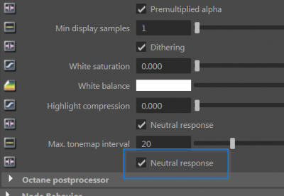

Hi Jim,
Please on all this version is missing the option in Octane imager "disable partial alpha" so when we are rendering with Octane "render layer" the alphas are wrong and Unpremultiplied.
If you don't mind to have a quick fix we need quite faster we are re-render other projects with render layers and is not working on the V03
Best,
JO

Actually the disable partial alpha is in the plugin but with a wrong label :shock:
As you have this second wrongly labeled neutral response option enabled, you have in fact the disable partial alpha enabled,
and this is why the image seems to have alpha "unpremutliplied" even if the premultiply alpha option is enabled...
The disable partial alpha option have been introduced in Octane3 core to help for this issue : viewtopic.php?p=269484#p269251
(so the option should be disabled most of the time)
Thanks Jo, to have highlighted this mistake in the plugin and the confusion coming with it...

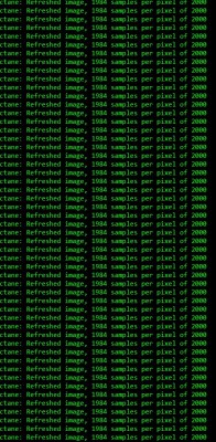

nedan
Posts: 52
Joined: Tue Sep 11, 2012 11:09 am
And sometimes render is never finish, just keep showing the same sample count forever, and this is happening close to the end.
nedan
Posts: 52
I found out, after few tries, why the render is hanging just before finish. He is waiting for a slave with problems. If I kill the slave the job is continued, if not, he's just waiting for this slave. Maybe if a timer is added until the slave can answer, will help for this not to happen again.
