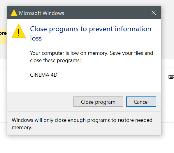

So the last few days we have been trying to render over night for a client project but are returning to the machine in the morning to a crashed software and only a handful of frames.
I managed to get a screenshot of the error before the whole system died...But was unable to get a crash report as Cinema 4D is never responding at this point.
Here are my specs.
Windows 10 Home // Octane Version 3.05.3 // Nvidia Driver 378.66 // Cinema 4D R18 Plugin 3.05.3
Asus X99-E WS // Intel Core i7-6800k // 2x 12GB NVIDIA TITAN X (PASCAL) // Corsair Vengeance LPX DDR4 3000 32GB
Could this be a problem with memory or is this software related?
Its important we get this sorted as soon as possible so help would be greatly appreciated.

If you have a lot of triangles from non-movable geometries and using auto detection(by default) that can happen. Plugin converts static meshes in a single buffer and out-of-memory is possible. In LV mode is all movable and so this is not happening. Because each movable objects are exported in small buffers. So this is not a bug for my opinion. Will be moved. Try All movable for rendering or add some object tags to objects. My advice is first method.

So do you think Octane is filling up system memory? I'm suprised this works like this when my out of core is set to 4gb I think.
Is it all ways good practice to set the render to all moveable when doing a final animation render?
Should I also turn off out of core?

Affari wrote:Thanks for the advice I will try this option today.
This is about export process for meshes in plugin not Octane. I think my answer is about geometries not textures.

aoktar wrote: This is about export process for meshes in plugin not Octane. I think my answer is about geometries not textures.
Sorry my bad. If this is the problem, it's hard for me to comprehend how the plugin or Octane is managing to fill up 32gb of ram with geometry.
You said before that 'this can sometimes happen when renderer is set to autodetect'.
It's fair enough when someone is getting a small error but this is causing a whole system crash.
