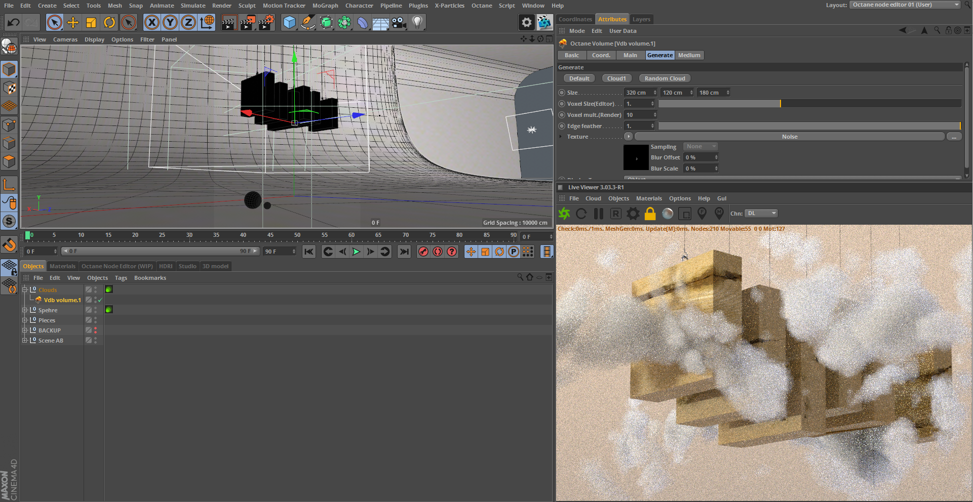

I created a scene and played with the VDB Volume. It renders pretty fast in the Octane Live Viewer And work fine but when i try to render using c4D export, it crash.
First i had this message : "Not enought memory" combined with "Octane pluggin crashed" so i cranked the memory up to 26k (it was 4 k) and only have the pluggin error message now.
After some tests to be sure that the problem is about the VDB Volume (and it is), there is one thing i cant figure out : Why it renders in seconds in the Live viewer and cant render using c4D export? I must have missed something.

Do you know what's the meaning of 10x multiplier for Render?

mmh No, sounds like this is my solution ahah. I'll have a look, do you recommend me a specific topic ?
I recommend that read and understand how voxels are handled in memory. See this page.

Ok i understand, at least i need to do some tests
Thanks for that quick response. I'll check that in the next hour.
my advice to divide your volumes to smalls to avoid out-of-memory issues.Andrea_Philippon wrote:Ok i understand, at least i need to do some testsThanks for that quick response. I'll check that in the next hour.

Thanks a lot! That was my problem, the multiplier was on 10.. so 10*10*10! A bit too much
It's working very well now! Thanks again, i have a lot of fun playing with this
