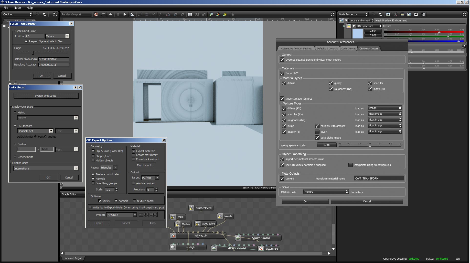

I thought it was going correctly, setup my system units to meters, display to feet (easiest for me), export scale 1.0, import settings in octane to meters > meters.
However, I was just running into some issues with lighting, and when I zoom outside of my model room, I saw the rings which I've learned is a scale problem, usually from the obj being way too big. I grabbed all the settings.
In max the left "box" room is 9' tall x 17' long by 5' wide.
Here's a partial grab of the obj output:

v 0.862733 0.059771 -4.836232I tried to export at .1, .01 but then i get almost no light on the inside of my room.
What could be going on, or is it fine as is? I'd hate to imagine that if it's at the right size I can never do an exterior shot...
