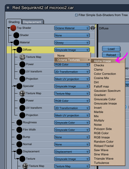

But, the Diffuse, Glossy, and Specular all offer Alpha Image in the channel shown in the attached image. This channel, for me, does not work with Alpha images.
Maybe it is not supposed to be offered for this channel? But, if is supposed to function, I would like to experiment with it.

It should work, but, you will just get a grayscale image (the alpha channel of the png) if you put it in the diffuse channel.

Actually, I am finding that the Alpha portion of the image renders black if unsupported by an Alpha image in the Opacity channel.
So really, there is no Alpha Image support in the top Channel, even though it is offered.
As an Alpha image, it seems that the Alpha function should be supported independent of the Alpha Channel, per the attached image of an Alpha Image in the native Carrara shader.
This is what I would like for Octane Materials.

Well, in my eyes, it makes perfect sense. The "Color channel" in Carrara is displaying colors (black, white, blue, red or no color [transparent] at all...). However, the "Diffuse channel" in Octane does not display a color but calculates the diffusion reflection for the material. The range is from high diffusion to no diffusion. So, IMHO, it would be really strange if you would get the same result as in the case of the Carrara "Color channel." :shock:

I see your point, as you explain it. Just was wondering why the Alpha Image was offered for this channel, and how one might use it. I was thinking that
it must be offered for some reason.

Well, I don't know if this is really the case as I explained it, but it would be my assumption :?
When it comes to an Alpha image, I'd say that the opacity equals diffusion reflection, e.g. high opacity equals high diffusion (or reversed).
