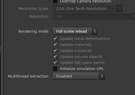

The problem is that you are rendering the scene in "Update scene" mode. In this mode, the scene extraction time for each frame is faster while rendering a sequence, but unfortunately, the objects that are not available in the first frame can't be updated.

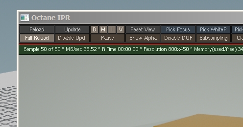

To render this kind of scenes you need to change the Octane ROP rendering mode configuration to "Full scene reload". Also in the IPR, you could need to enable the "Full Reload" button to reload the scene for each frame.

I'm guessing because I'm on a Mac that I don't have all those options in the IPR window.
My IPR window has no buttons in it at all and I can't figure out how to make them appear, so I just figured that was how it worked on Mac OS.

Yes, true. I need to add this option, and some others, as a command to control the MPlay IPR using commands, hotkeys, or icons on the shelf. All this stuff are planned features to be added once I have finished the current H16 and Octane 3.06 builds.
Anyway, the final render from the ROP node should work fine.
