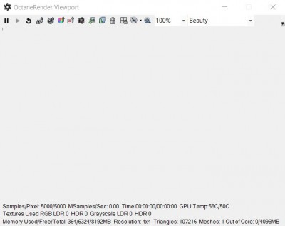

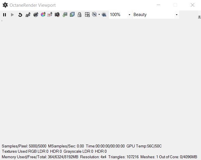

My general workflow involves exporting obj files and rendering with the standalone version. I downloaded a demo to test the plugin workflow in Rhino. Unfortunately the same scene which works fine in standalone is only shows as a white screen in the Rhino Octane Render window. Any help in trouble shooting this is much appreciated.

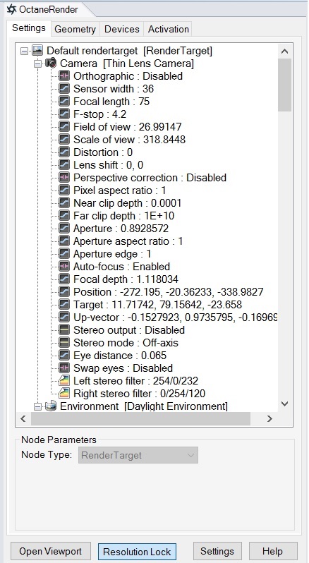

Hi - I have no seen this before. It appears to have rendered 5000 samples in 0 secs. Can you pls save the scene causing this in Rhino format and send it to me? Also - can you post a screenshot of the Octane tab->Settings tab->Camera settings. Finally - what is your Rhino Layout set to? And what Viewport type do you have selected when you open the Viewport?

Thanks, and can you post a screenshot of the camera setting after you have opened the Viewport pls?

Attached.
Camera settings
Camera settings
