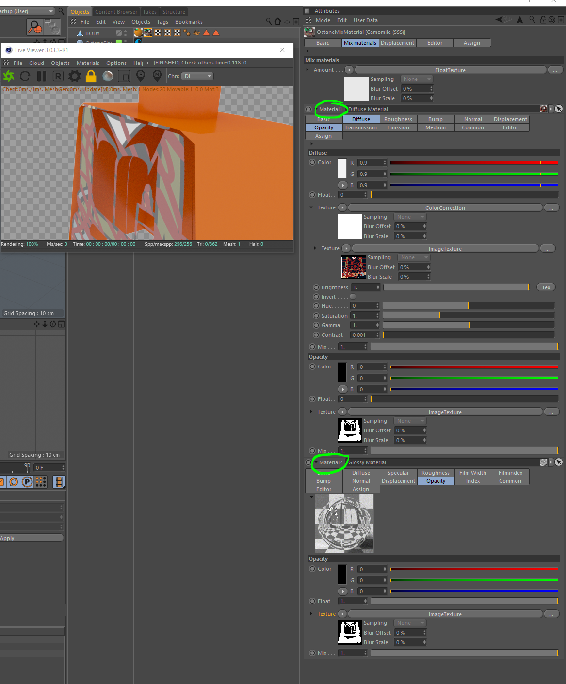

I can't figure out how to get 2 texture/materials to work together. I want one material to be the base colour, and a second texture to be an image overlayed on top. For example, Orange plastic base with graphic lego artwork on top.
I downloaded a texture from Live DB as a start since it included an image, but am stuck.
Hope someone can quickly help out as I'm on a short turn around.
Thanks in advance.

Put transparent image to amount slot from mixmat.

Thanks!
