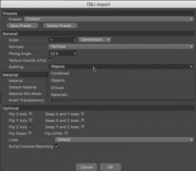

do you have also a .mtl file along with the .obj file?
If yes, you can open it with a text editor and check if the materials are specified or not.
Then you can import them with R18, that has been improved in the .obj import:
Or wait for Riptide activation, it has all the necessary options and more.

Actually it did come with a .mtl file and it works just fine when opening it. Thanks so much bepeg4d. Just saved me hours of work :)
