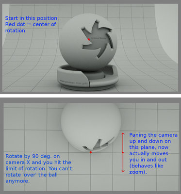

The current camera rotation implementation (euler angles?) is limited, regardless of export options. Consider this procedure on a blank scene:
Now to compare how the camera behaves in Blender, for example - you can rotate around an object 360 degrees any amount times without hitting any walls or shifting panning axes. You can rotate, pan & zoom anywhere without loosing degrees of freedom. The camera rotation in Blender is implemented with quaternions = no gimbal lock.
Rendering in Octane is all about finding the right POV, not exporting it from the 3Dapp - so this crippled camera behavior should really go away.
