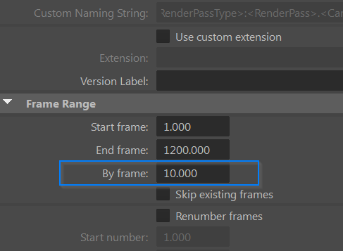

BUG: "by frame" setting and internal motion blur, render fail...
To render correct rotation motion-blur,
as for some reason the Plugin doesn't sample motion at higher frame-rate by himself (unlike other renderer),
we don't have another choice than to increase the scene frame rate and increase accordingly the "by frame" setting.
That's not very handy but could do the job if it was not broken ....
MotionBlurInternalByFrameBug.zip
Sample scene with frame rate increased to 250 fps and the "by frame" setting increased to 10.
(12.91 KiB) Downloaded 280 times

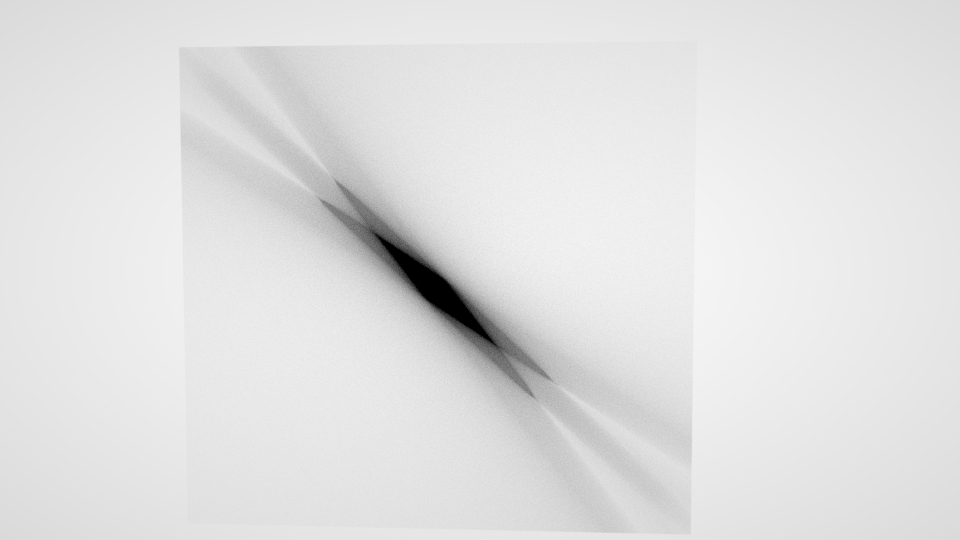

@Jimstar,
At least can you add a Sub-sampling setting to the internal motion-blur please ?
(with default to 1)
This is needed for fast rotation motion-blur and for sub-sampled dynamics.
Here how looks currently in Maya the motion-blur of the rotation of a propeller :shock:

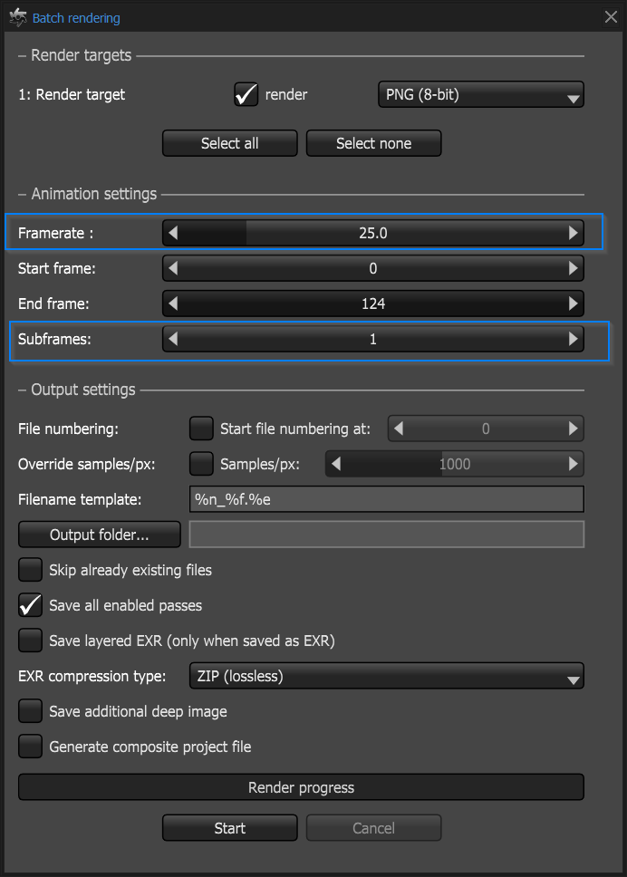

@ everyone having this problem,
the only workaround for the moment is to increase the frame rate of your scene (for example 25 fps to 250 fps), export to ORBX,
and render in Standalone with Batch Rendering, take care to set back in Standalone the Frame Rate to its original value of 25 fps and let the Subframe value to 1.
then the propeller motion-blur won't be square anymore but will describe a perfect circle.
Pascal ANDRE
