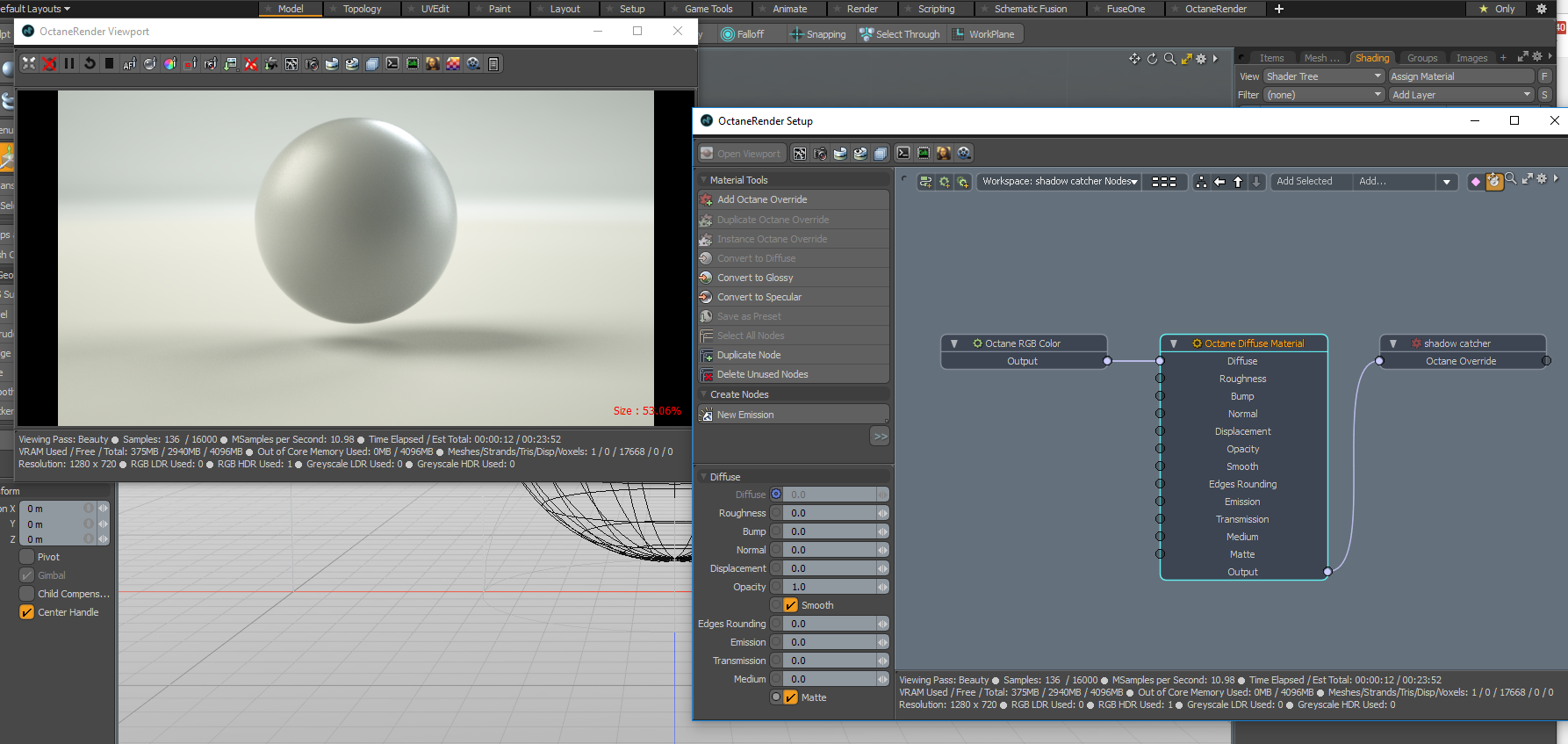

What am I doing wrong when I cant get the shadow catcher to work, I am using a IBL (why is it turned inside out?). I have activated the Alpha in Settings and Diffuse and Matte on the material.
And does this also transfer to the PNG when I export for Video?
Thanks in advance.
Shadow catcher with IBL enviroment

Tick Matte on the material assigned to the surface that is rendering the shadow. The shadow will be black, and the non-shadow area will be invisible.
