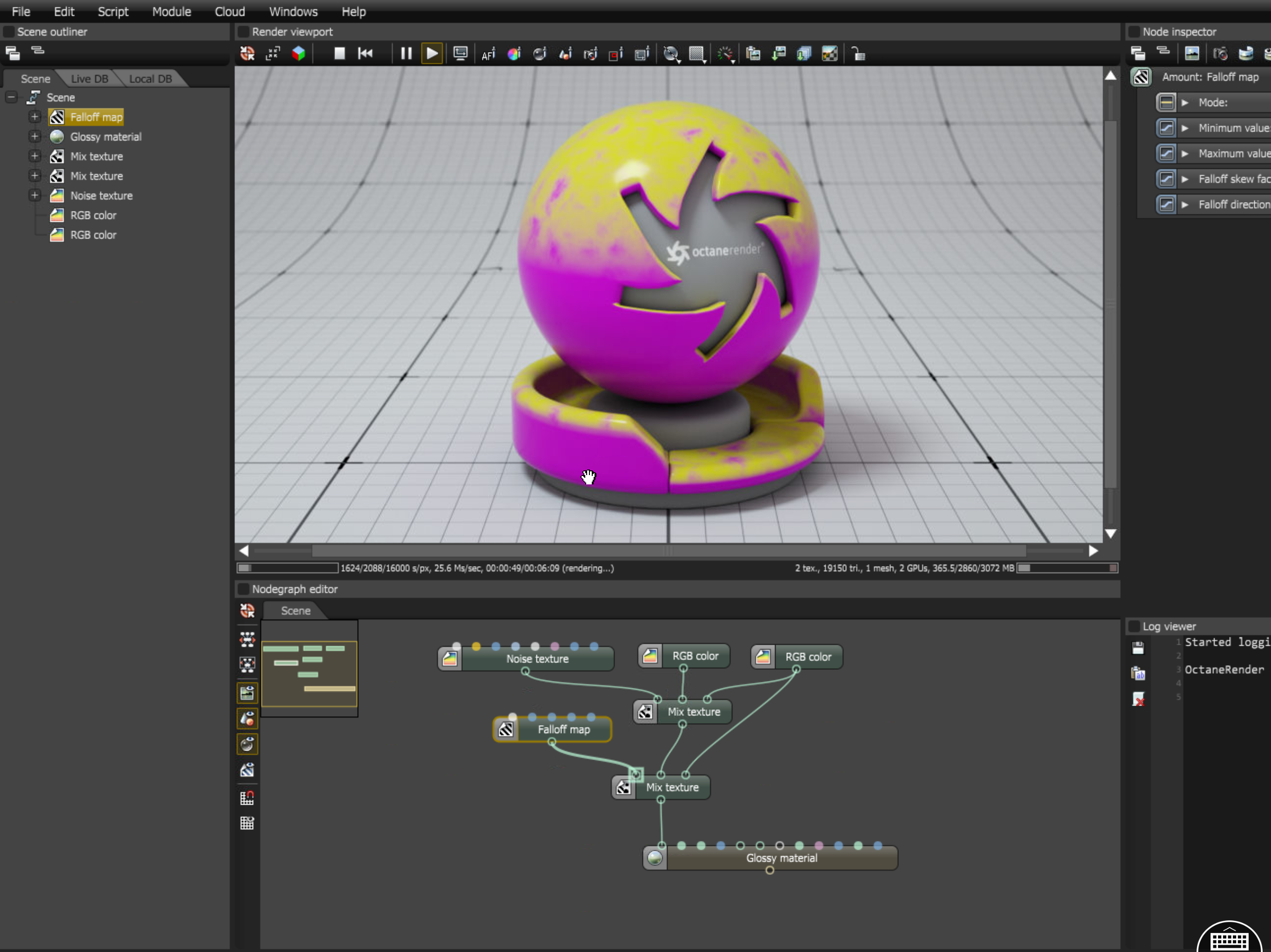

I have a mix texture using a texture image as amount, first texture is a texture image and second is RGB color.
If I set a falloff map on the mix texture, it contributes to the mixing value (not what I need), if I set it to the first texture it doesn't affect the second texture, the RGB color ...
How can I set a falloff map applying on the mixed result ?

Hi Enrico,
do you mean something like this?
The noise is the amount of the mix of the two colors, then the mixed version is mixed with the second color with falloff in the amount.
ciao beppe

Not exactly because as you can see the texture disappears and is replaced by the RGB color because the folloff acts as the mix texture. What I need is the same effect as the falloff if it was used as the power on a texture but on the global result of a mix texture, duno if I'm clear :?

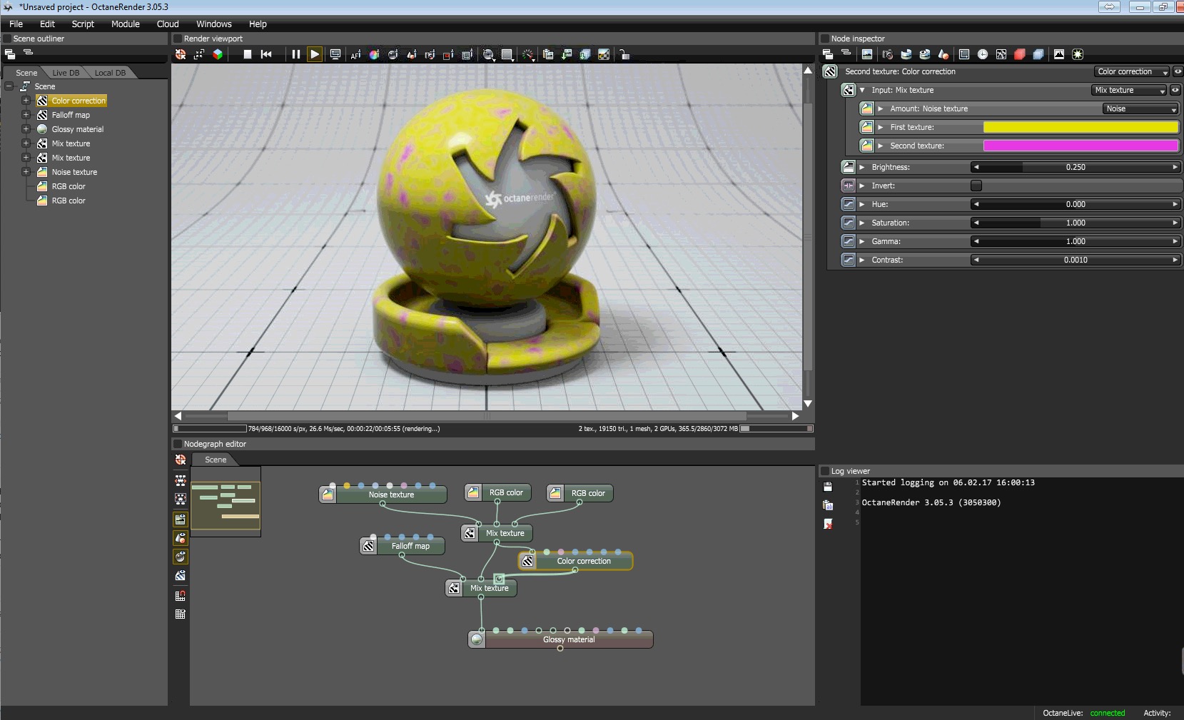

Well that could be a solution but not exactly what I'm looking for.
Seems that it produces some strange artifacts ...
