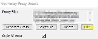

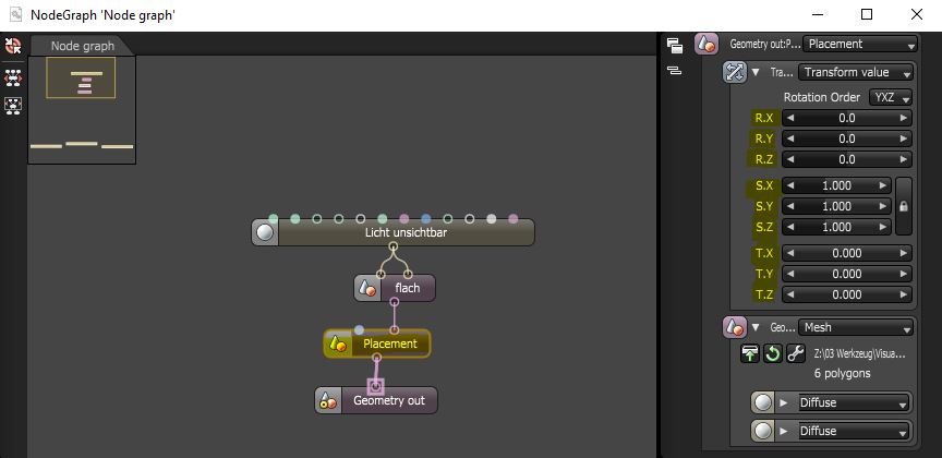

You don't need any 3DsMax. You could use Octane Standalone, but it is also not necessary. Use an OCS or ORBX for Proxies instead of a simple OBJ, what includes a "Geometry out", a "Placement" and your OBJ-Mesh. Than you can edit your Proxy directly from ArchiCAD.
Most of the OBJ are placed in the middle, but if it is not, than you can correct it with the "Placement".
The Scaling is very tricky as well. You can use different Length unit (Meters, Inches, these are the common units for an OBJ). If you choose the correct one, than you don't have to correct anything with scaling.
