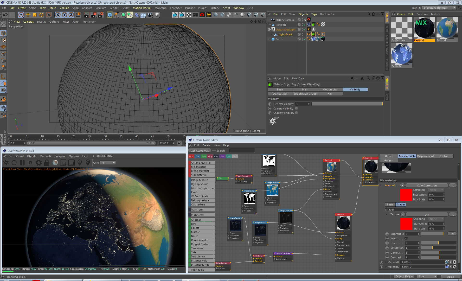

nice tutorial and nice textures, here is a possible fast reinterpretation with c4dOctane shaders only:
EarthOctane.c4d.zip
(100.86 KiB) Downloaded 483 times

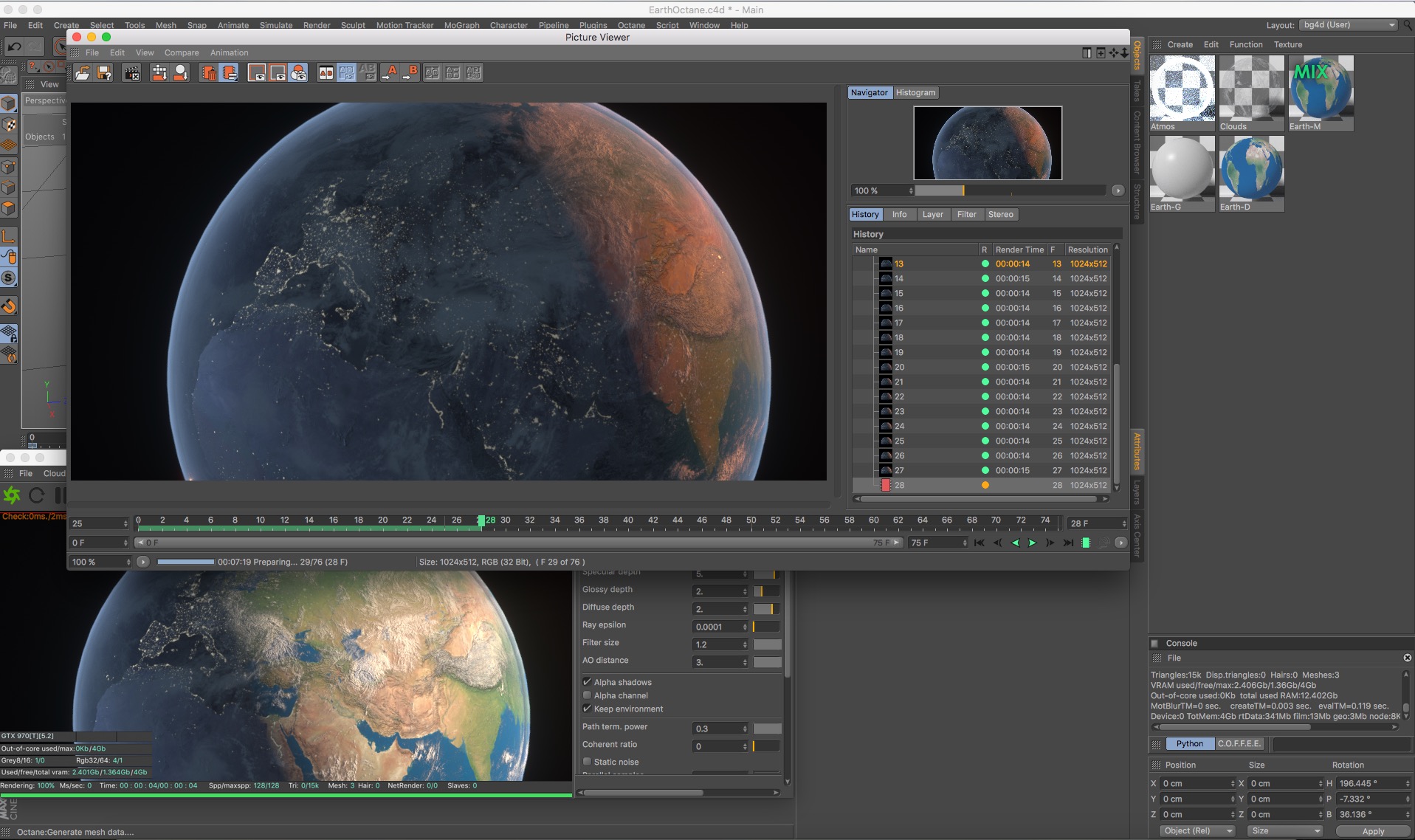

try with this diiferent version, this time the Mix Material Amount is driven by the Dirt node, that react to a semisphere hidden to camera and shadow, and parented with the light:
EarthOctane_05.zip
(135.56 KiB) Downloaded 361 times
