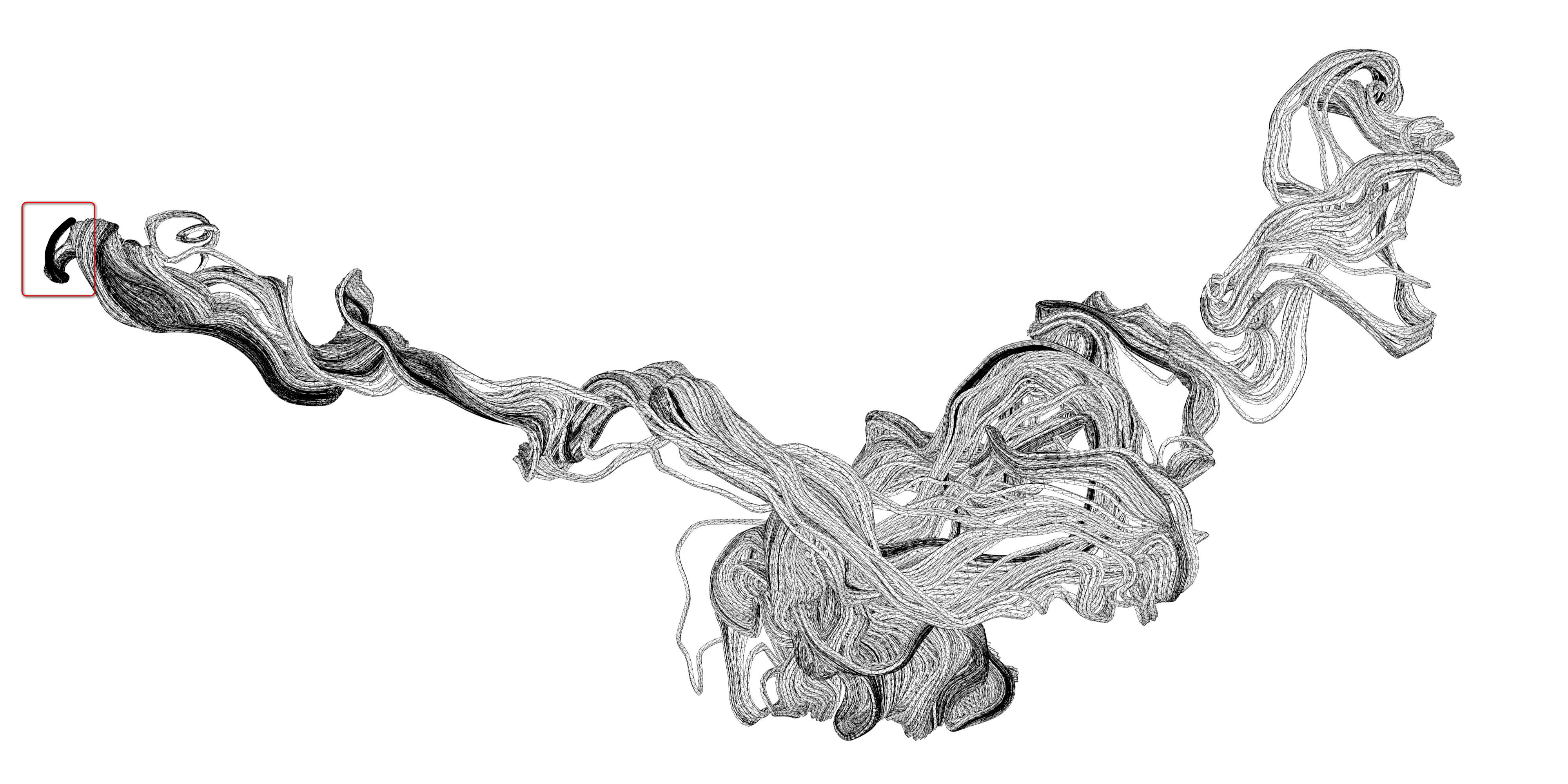

The problem is the way how the geometry is arranged. It looks really cool, but there are various areas, where there is an insane amount of very elongated triangles, especially at the marked place:

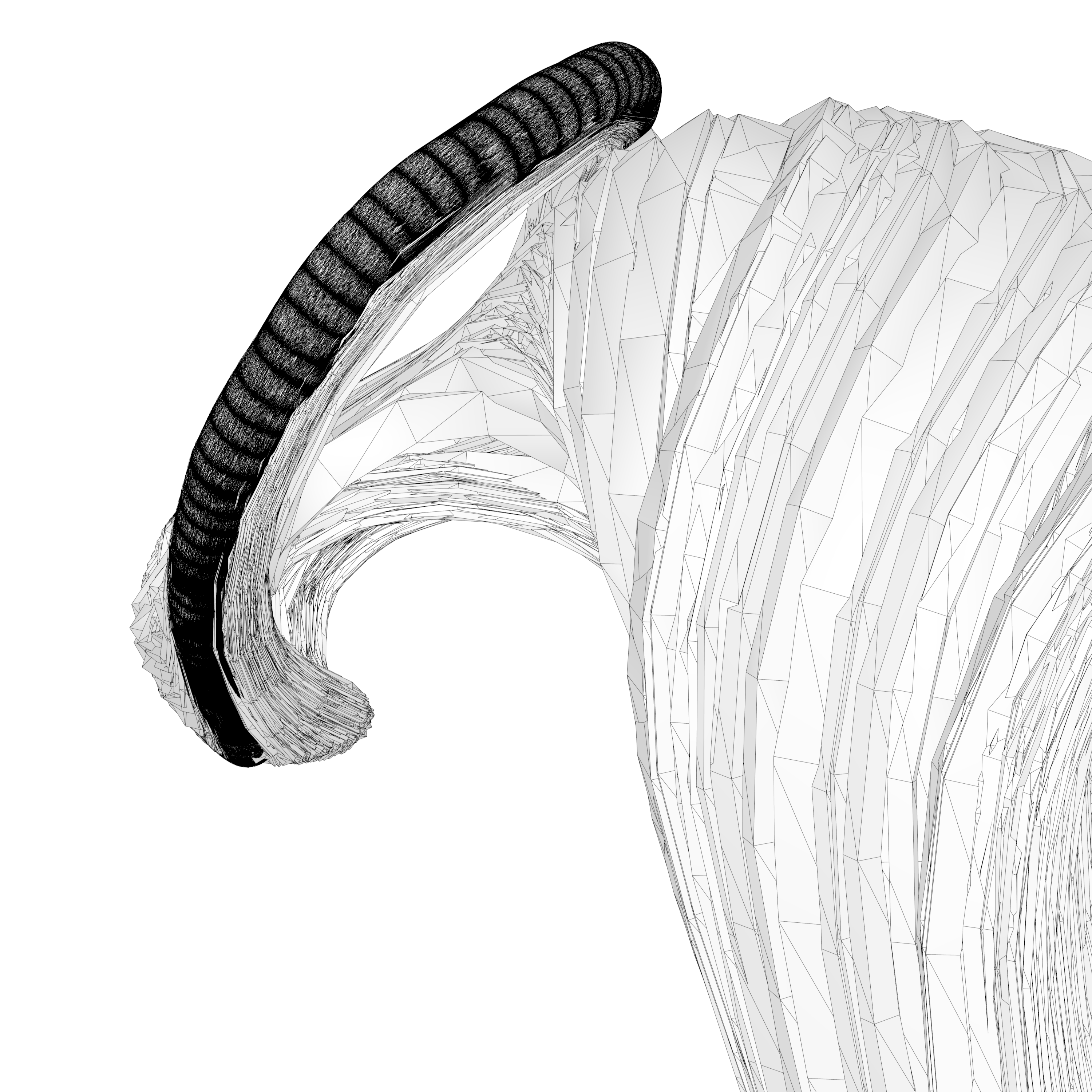

This is this area zoomed in;

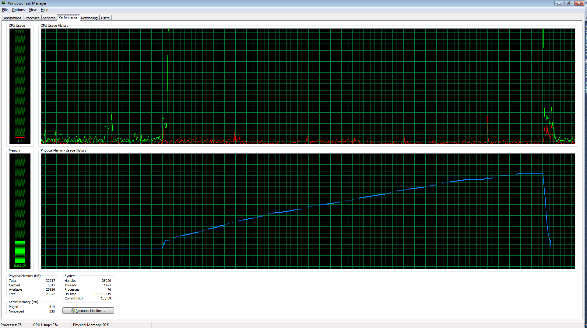

When this geometry gets compiled Octane has trouble finding a sensible subdivision scheme and you probably run out of memory causing the system to start swapping:
I don't think there is anything we can do in the near term, but I will add it to our test cases for when we are going to overhaul the geometry pipeline.
