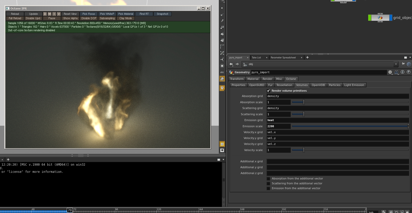

Would you mind to help me with fire shader, fire made in Houdini. Hope it will be video tutorial. Thank's a lot)
juanjgon
Posts: 8867
Location: Spain

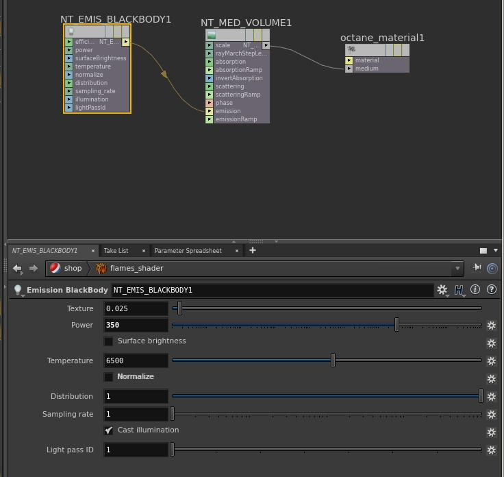

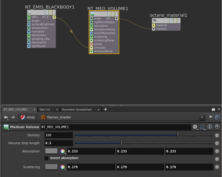

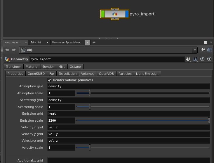

Attached you have a sample scene to study it. It is easy, you only need to use the blackbody emission node to configure the emission grid. If you have any problem, let me know.
Thanks,
-Juanjo
