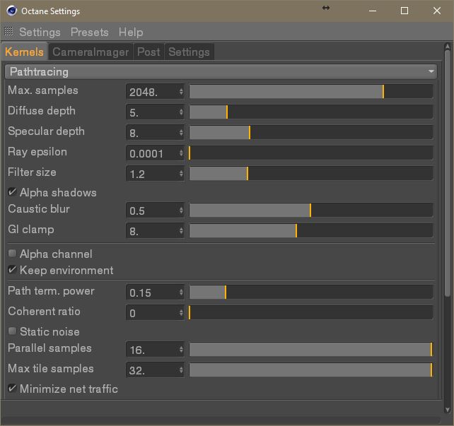

What's yout render settings? By default it's set to auto mode to detect movable objects,etc.. It will just update changed parts. And all movable option in render settings will cause same operation as in LV's default state. There's not much different LV vs. PV. Just another one is about subdiv or hairs. LV use viewport data and PV is feed by render data.
Are you sure that you consider export times in Live Viewer? And do you use subdiv objects?

Hi Aoktar,
render settings are those: for the preview i set only 128 passes
thanks for the tips, I've searched for all the subd surface in the scene and replaced them with the octane tag with subdivision group setted to 2 (it was the same subdivision level I had before, the software now subdivide the object directly in render phase instead of sending a bigger subdivided surface, right?), disabled out of core textures, and set geometry engine and geometry Control as per default.
Now i can see really good timings, like 10 seconds per frame.
