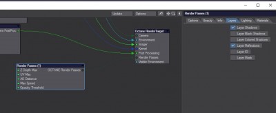

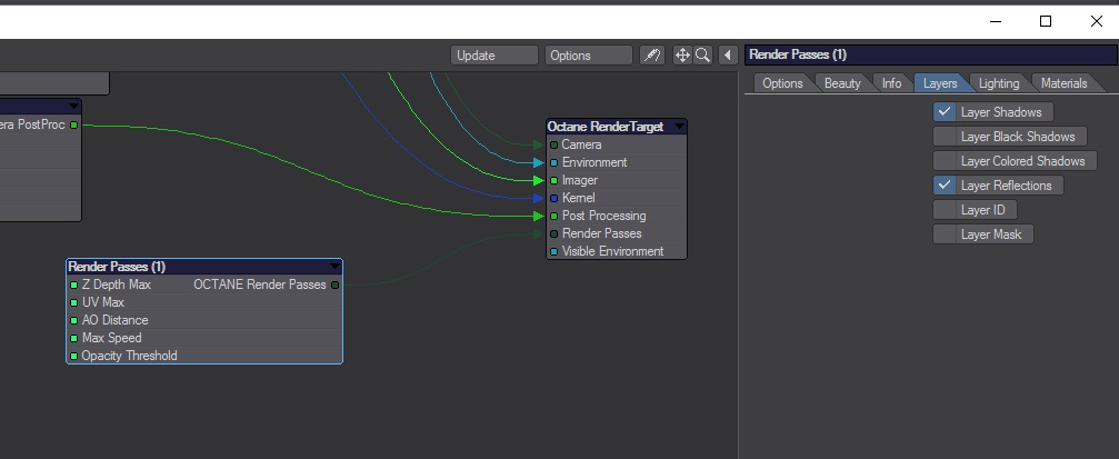

juanjgon
Posts: 8867
Location: Spain
To get the shadows and reflection you can try the layers passes. Enable the shadows and reflection layer passes to see if this is the information that you are looking for.
Thanks,
-Juanjo

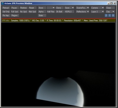

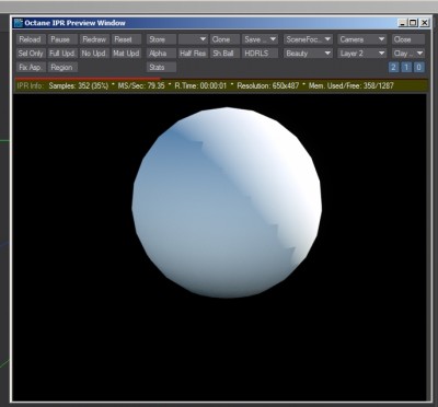

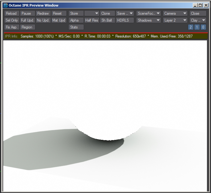

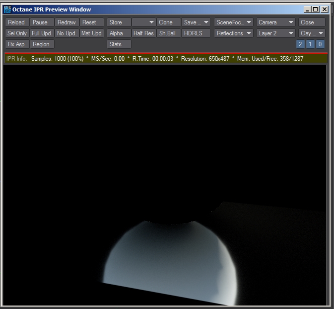

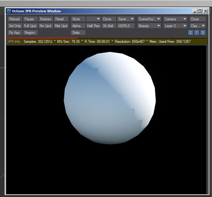

juanjgon
Posts: 8867
Location: Spain
Hmm, it should work. Check the attached scene. The sphere is in the layer 2. The beauty pass in this layer has the sphere, the layer shadows has the shadows over the floor and the layer reflections has the reflections also over the floor. Is this what you are looking for?
Thanks,
-Juanjo

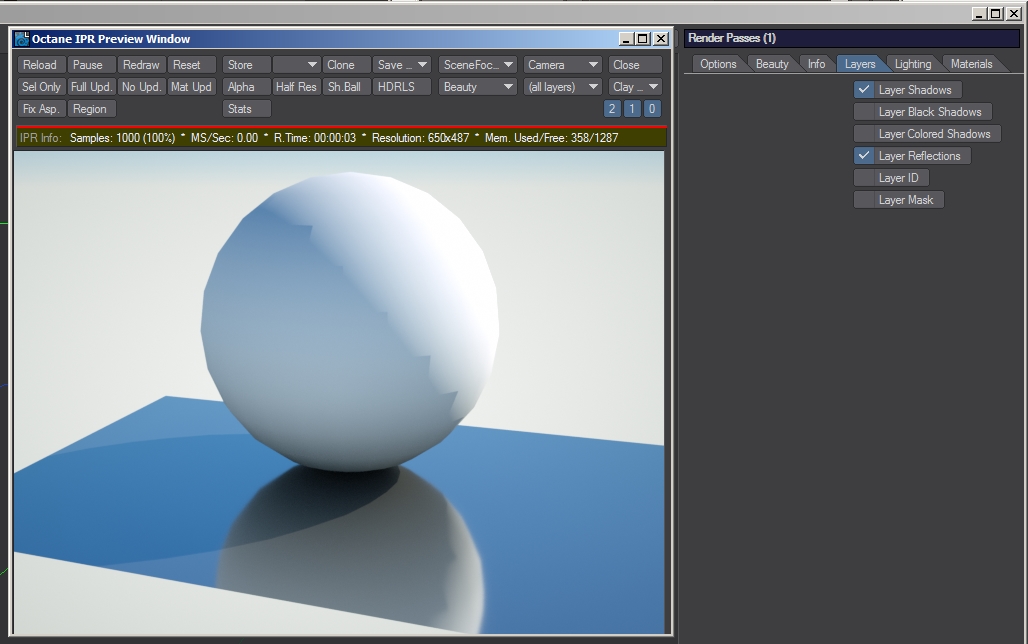

sjonsjine
Posts: 189
Joined: Mon Mar 01, 2010 11:20 am
Location: Amsterdam
Hi Juanjo, thanks, we are getting closer ;-)
It works in the preview window, can see it when selecting the shadow or reflection or beauty layer.

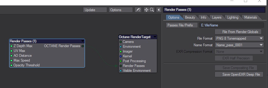

But now, how to render this with F9 or scene rendering? How can I save the layers now?
Thanks!
Freddy

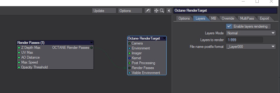

juanjgon
Posts: 8867
Location: Spain
To render the layers you need to enable the layers rendering in the render target root node options panel, and to configure the passes file names and options, you need to check the render passes node options panel.
