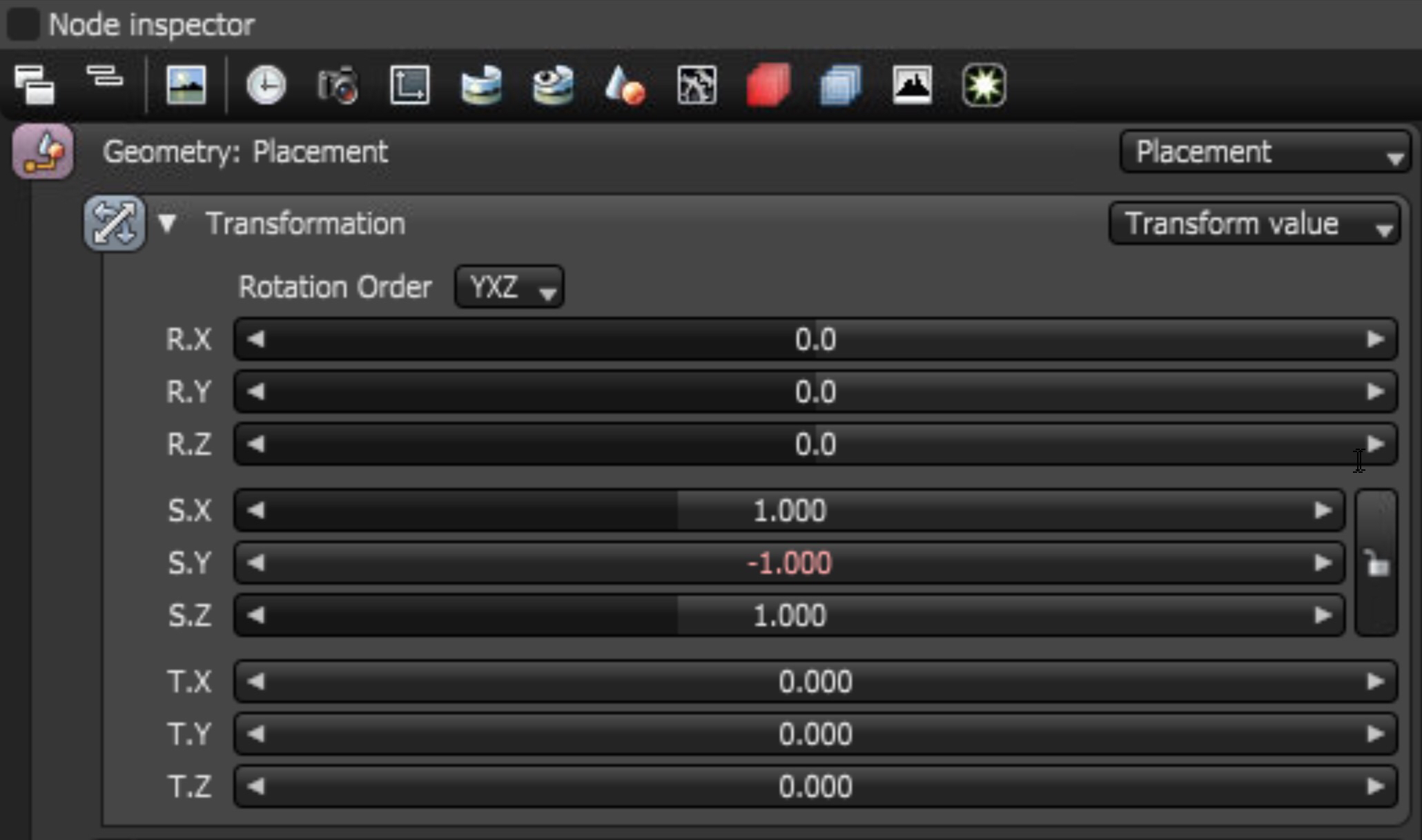

another more easy way is to add a placement node between any kind of geometry node, unlock the scale, and set e negative value on the desire axis: ciao beppe
