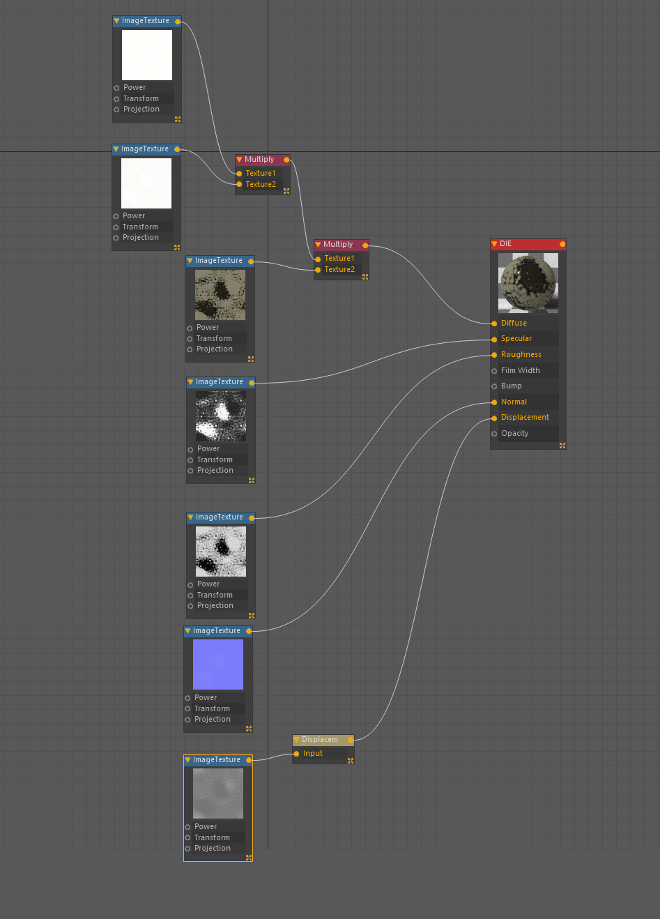

to create a material from megascan materials sets, you have to create nodes like the picture enclosed. limit the displacement parameter to less of 10 to be realistic.

You can also multiply AO and cavity with the diffuse map to compensate for the Ambient occlusion lost as the displacement can't recreate all the cavities and micro holes of the original surface.

Perfect... how do i do that exactly? Sorry complete newbie :shock:

This is RDT's textures but its the same setup as Megascans pretty much its pretty simple
https://www.youtube.com/watch?v=0CYwHccQPMQ

cavity is the same as bump map ?

bertritude wrote:Hi,
you could use it as a bump map. I found many uses for it.
for masking too
