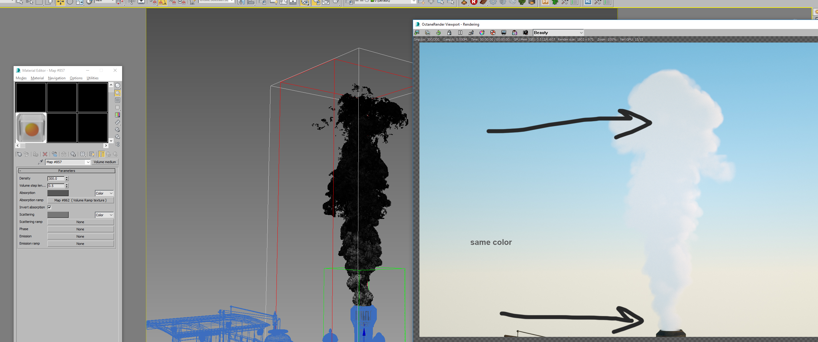

why do not absorbtion/scattering ramps work
coilbook
Posts: 3176
hi is there any way to have darker smoke coming out and dissipating to white? Ramps do nothing thank you
coilbook
Posts: 3176
looks like max grid value solved it. Does anyone know what is max grid value for? Thank you

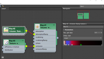

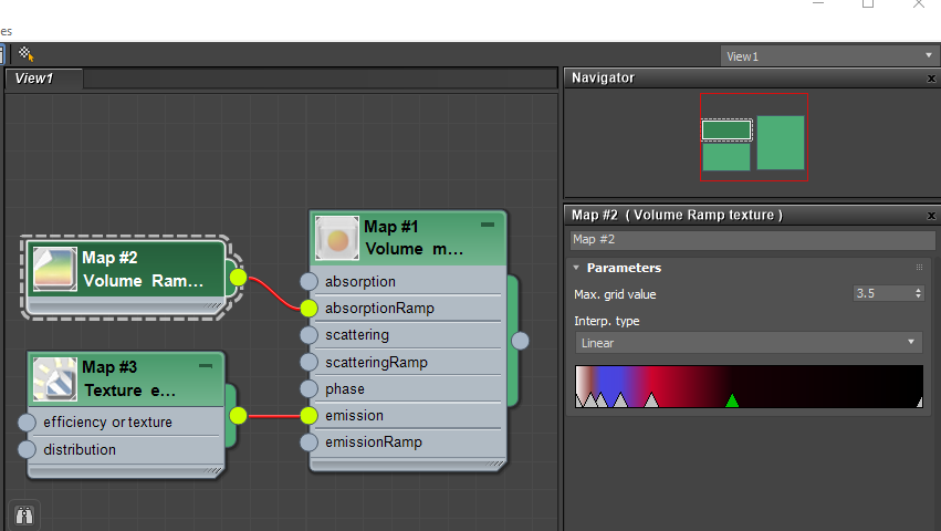

Posts: 1579
Hi guys :)
I am not really a Phoenix power user, however, my test worked fine with Volume Gradient ramp node. Please try setting up the volume gradient ramp shown below and let us know how it goes.
The attached file is created using a Demo version and the values will work according to unit setup. I hope you will find this helpful.
oct_phoenix.7z
(112.49 KiB) Downloaded 340 times
