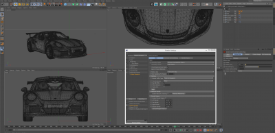

Hi. I have a question about motion blur. I´m doing a scene where a car is moving fast over a road. The camera is parented with the car so it moves with it, so I want only the road and background to have motion blur but not the car itself. For some reason Octane is applying motion blur to the car as well even though it moves with tha camera. Any ideas why or how to fix it?

ghm, now that's strange. Are You sure Your camera & car moves together?

@rafaelvamp: Thats strange on both my automotive animations I think I have used the standard motionblur settings, only upped the time sampling per frame a bit. I also only added an octane object tag to the tires. I can upload a screenshot of the octane render settings for motionblur when I am back home ...

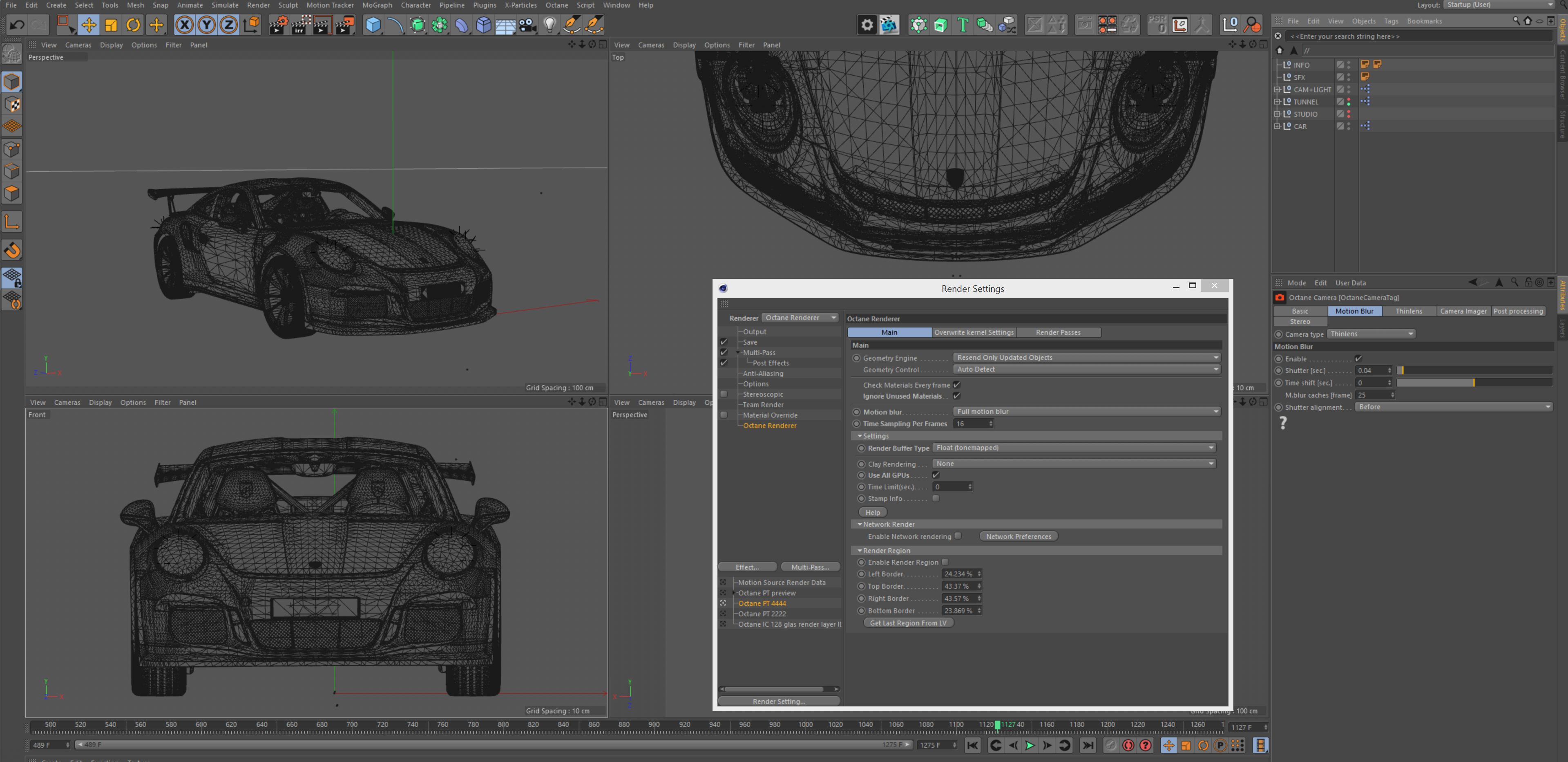

Here are some settings I used
