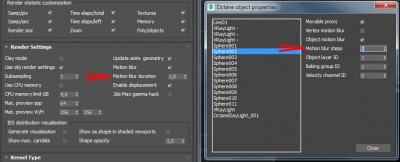

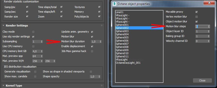

no errors here v4.26
https://youtu.be/yOjO959a_-s
settings:
Movable Proxy - check
Object Motion blur - check
Steps - 2
Kernel Motion blur duration - 0,5
settings:
Steps - 2
