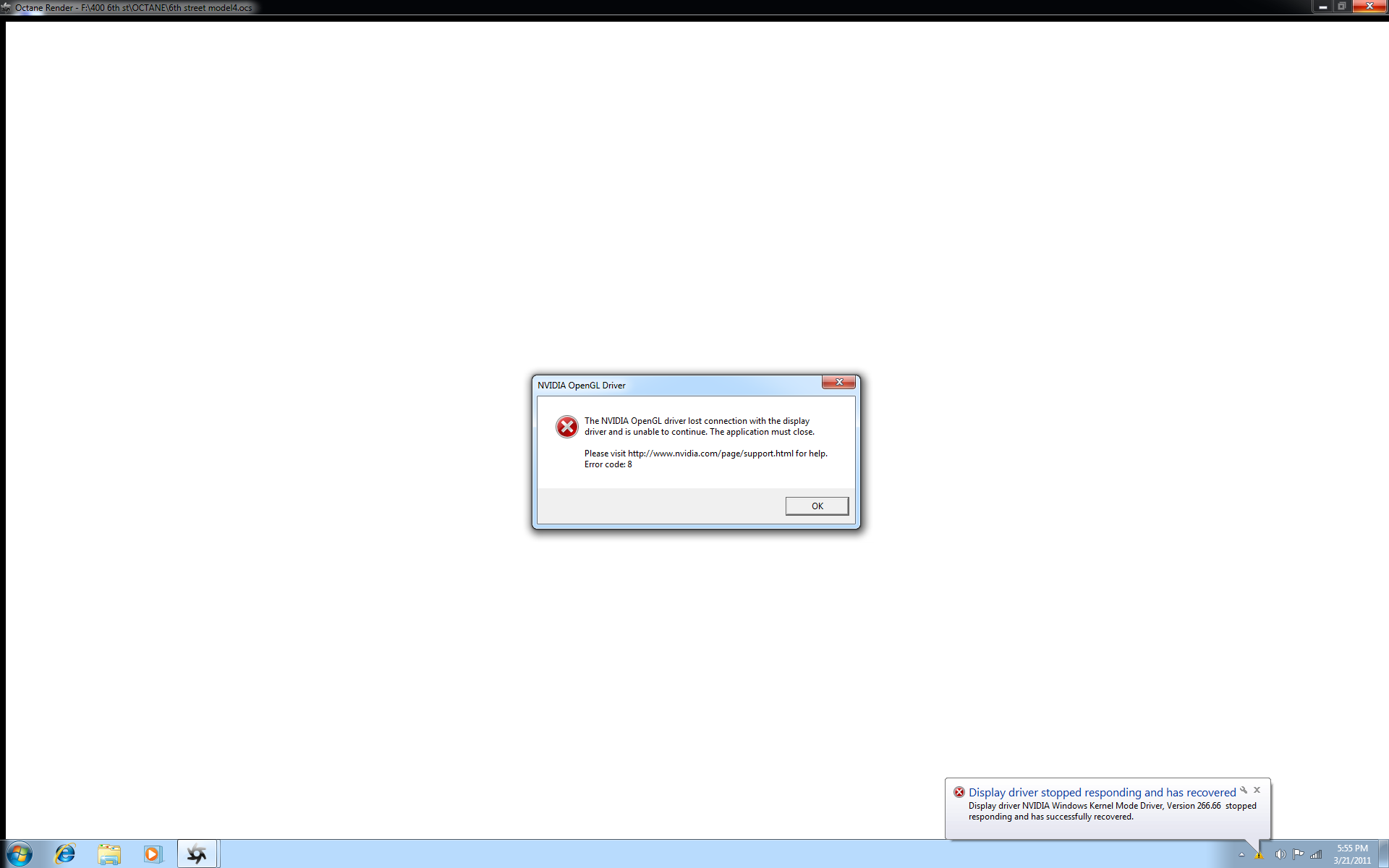

No, I'm pretty sure that what you see is the timeout recovery of Windows - see here:
http://msdn.microsoft.com/en-us/windows ... e/gg487368
Usually the installer fixes the problem by disabling the timeout, but it gets applied only, if you really run the installer and then reboot Windows. You can also manually disable the timeout by changing a key in the registry. If you need some help here, please let me know. It's described in the MSDN link above.

Hi Marcus.
Here is the message that happens... Any assitance you can give me would greatly help as I am not comfortable tinkering with the registry for lack of knowlendge.
