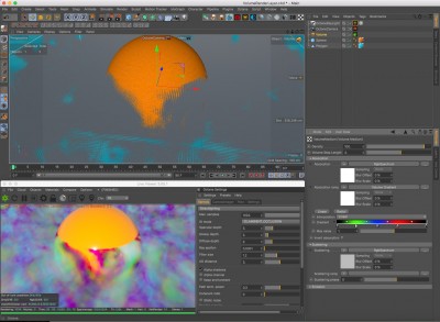

Is it possible to Scatter multiple colors in a Volume Medium? I thought using a multiple colored Volume Gradient in the Scattering slot might do it but nothing happened.
I don't want it to be emissive, just to scatter light pointed at the volume in a range of colors. Possible? If not, at some point? Thanks all.
Posts: 10598
I don't know if it is what you want exactly, anyway, here is a volume colorful version with volume gradient in the absorption channel:
VolumeAbsGradient.c4d.zip
(89.01 KiB) Downloaded 395 times
ciao beppe

bepeg4d wrote:Hi,
ciao beppe
This will work. This is in the manual now that I see your example I'm reminded of that colored smoke plume in the Absorption Ramp section. Thanks! Molte grazie.
