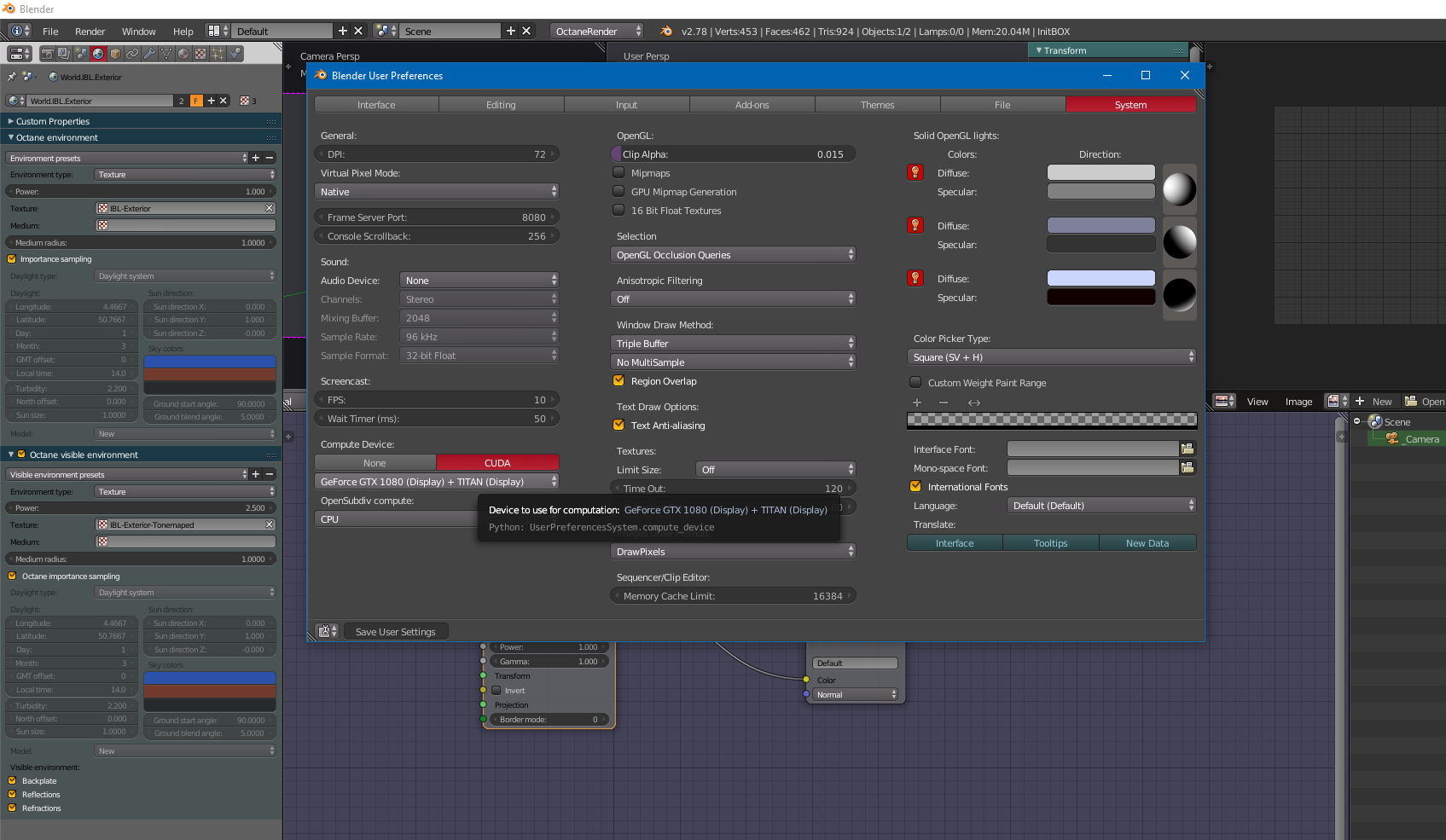

There is no option for enabling CUDA for Cycles in Preferenced under "Compute Device" (version 11.20)
I believe if was possible before.
CUDA for Cycles disabled

Version 11.11 had this option enabled. Has it been turned off in 11.20 on purpose?

Version 11.21 - GPU Cycles rendering still not working...

At least on the Linux side, Cycles hasn't been included in the plugin's version of Blender for a very long time. Jimstar has said that he wasn't able to get Cycles to compile in with the Octane code changes.

Version 11.21 had it working. I have not seen any information from Jim why and when it was disabled.
