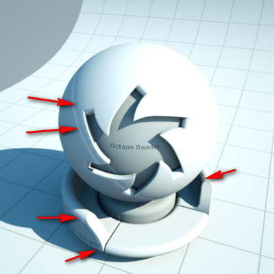

I have made a small change to solve these shading issues:
shading issues.png (239.79 KiB) Viewed 3641 times
As changes in that area often cause headaches in other unexpected places, I would like you to test a special build that is based on beta 2.44 and adds only the change to solve the shading issues. This is what you get from the same scene with the test build:
shading issues fixed.png (171.24 KiB) Viewed 3641 times
If you don't find any problems caused by the fix, we will add it to the upcoming release 2.45 which (hopefully) fixes this issue and some more.

Thanks for testing and giving some feedback.
The self shadowing at the terminator is not affected by it. You still have to manually set/increase the ray epsilon to reduce self shadowing artifacts, but now you don't get the shading problems behind the terminator, when you have a large ray epsilon, which you had before.
I'm currently thinking of several approaches to hide the self shadowing in most of the cases, but didn't get around to try them out yet.

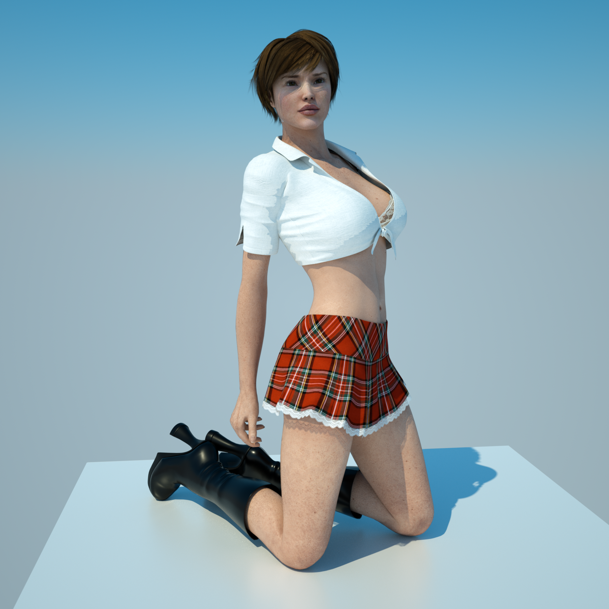

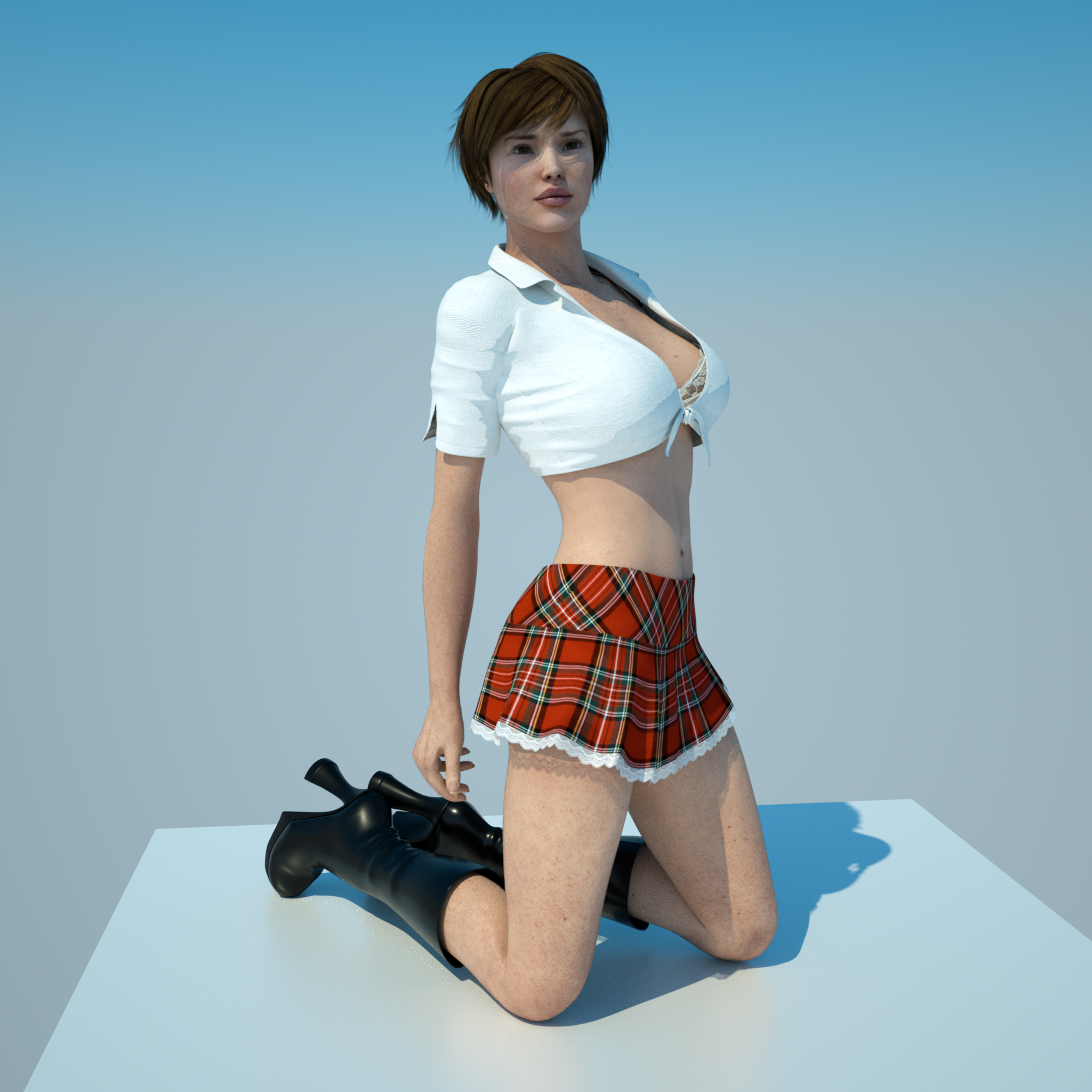

There seems to be an improvement in the smoothness of shadows as seen(if you view full size) on her top.
Is this expected?
Current release
Current release
Shader test
Shader test
