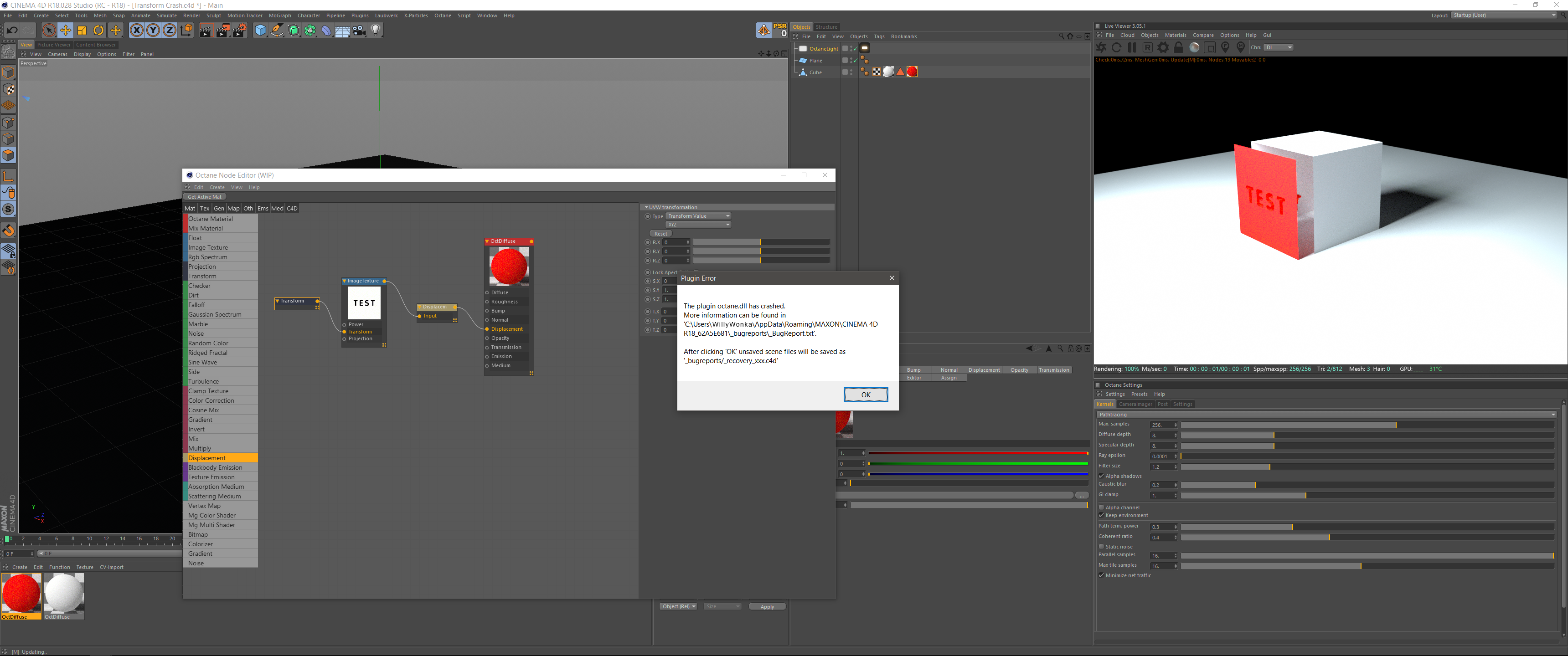

I am short on time, but have encountered crashing when accidently typing a value of "0" into the field located at:
Node Editor> Transform Node > UVW Transform > S.Y (Setting this to "0" causes a crash).
Please see signature for system details and feel free to let me know if more info is needed.
Transform Node Under Displacement Node Crash

Basically, when a value of zero is entered into the transform node's S.X attribute, I get a consistent crash. This is when using an ImageTexture node with a Displacement node.
Steps:
Setup basic environment
Make cube
Make editable
Apply texture
Create Poly Selection
Apply second texture to selection
Setup Displacement and imageTexture nodes
Setup transform node, set S.X value to "0"
Crash
I've also taken the time to attach a screenshot and the scene file.
Thanks for taking a look!

Thanks for very good information. That's what i need as always. Here as you can see it's not about transform node. It's about being under displacement. It crashes in standalone too. I'll report it to Octane developers. thnx

Octane Standalone already has a floor value but can be overridden by the user, so the case should be handled anyway, also if such value is provided by any plugin.Jaydekay wrote: A: Set a floor for the values within the input field so that they can't go below a number that your team finds reasonable. For instance, if I type in "0", the field sets itself to something like 0.00001.
This will probably be the desired behaviour by most users. We'll release a new version of Octane with this and other bugfixes this week, so you can expect a new version of the plugin after that happens.Jaydekay wrote: C: Try to handle the numerical problem under the hood..
