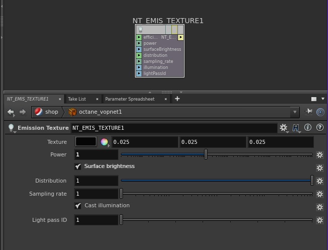

--On the EMIS_TEXTURE node, I have "SurfaceBrightness" ticked on, power set to 1, which I *think* should basically mean "just give me the raw pixel values of this image".

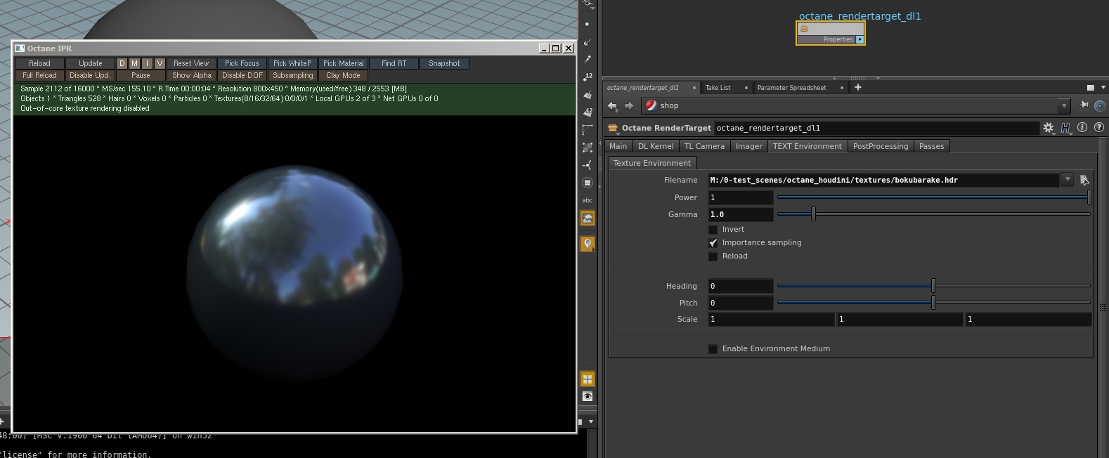

You don't need an environment sphere object at all to render IBL scenes in Octane. You only need to add the Render Target HDA, set the environment to "Texture" in the main tab, and select the HDR image in the TEXT Environment tab. Done!
If you want to build your own render target node graph, you must use the texture environment node. Be aware that you should set the texture environment gamma parameter to 1.0 for any HDR image.

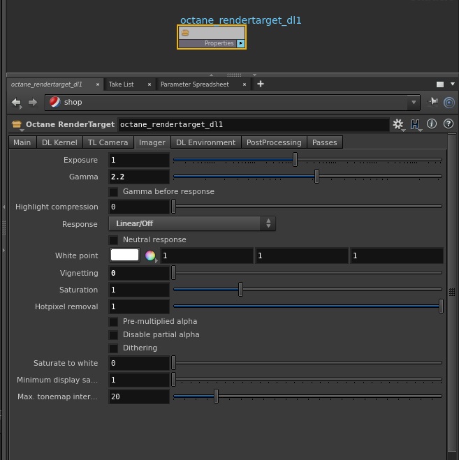

The brightness difference can be related to the Octane tone mapping options. With the default Imager settings, the Octane render is not going to match the Mantra render due to parameters like the film response or the vignetting effect.
If you want to match the Mantra rendering, your probably should set the Response to "Linear/Off", the Gamma to 2.2 and the Vignetting to 0.

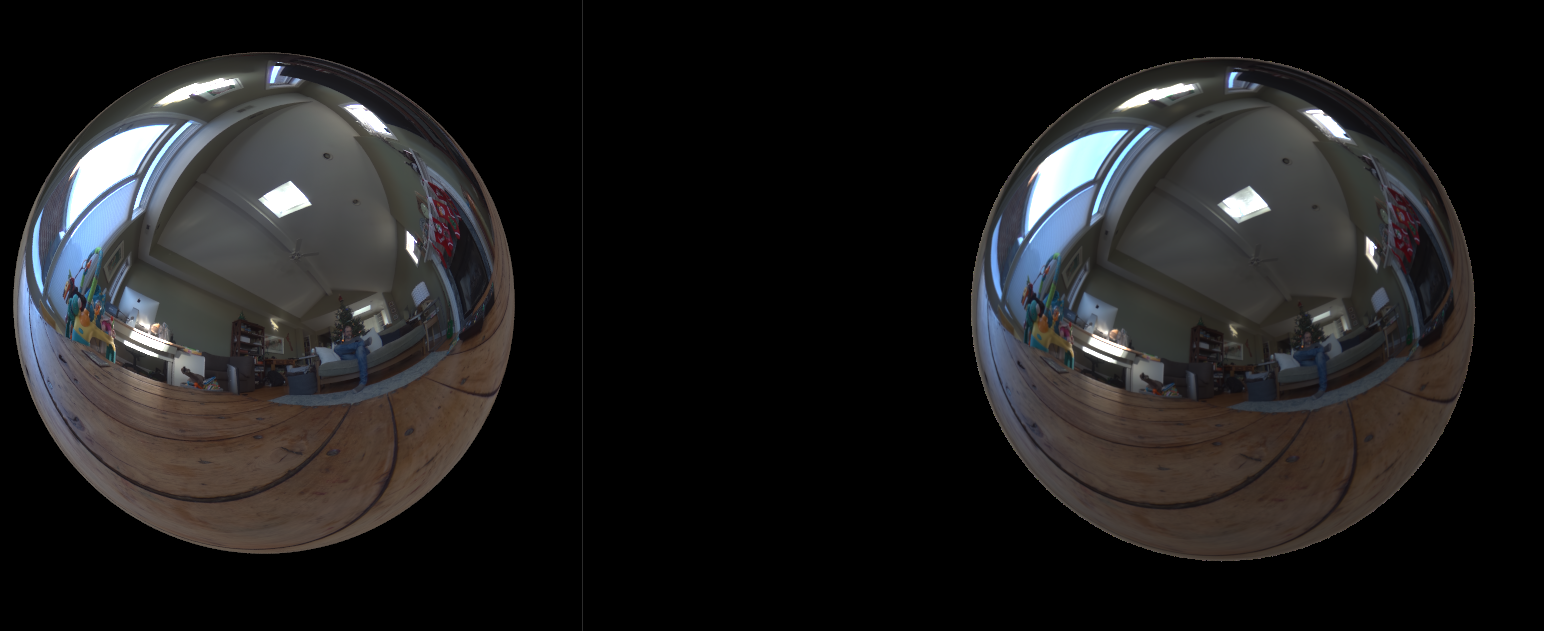

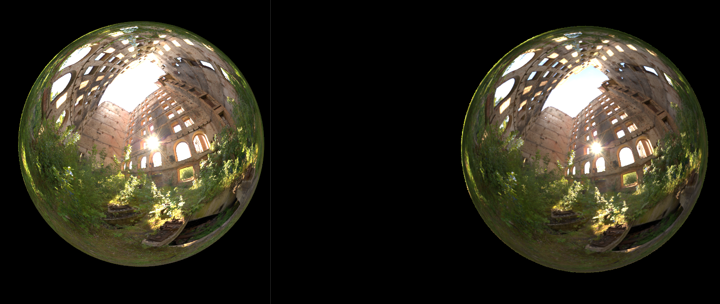

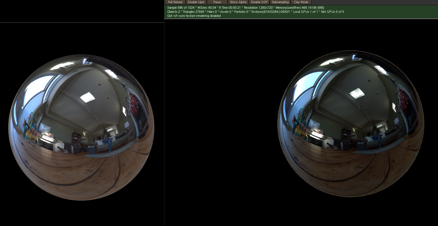

Unfortunately, I'm afraid that, even by following this advice, I still see a discrepancy between Mantra and Octane:
To double-check myself, I've even tried a few other HDR images; again I see discrepancies:

Hmm, it is hard to say. Let me build a sample scene here to see if I can find the source of these rendering differences. In theory, while working in linear space the render should be the same, but it seems that at some point there is some kind of gamma or tonemapping correction.

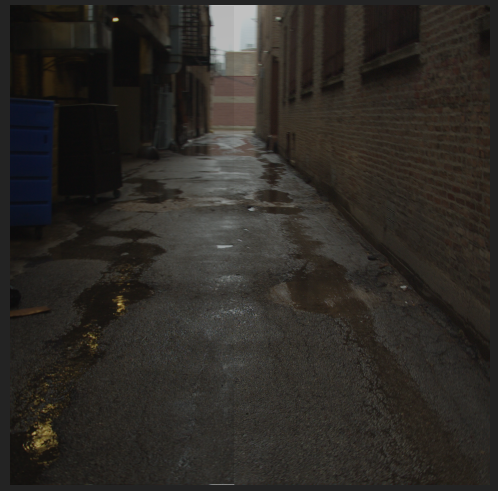

I'm running into another issue that I think could be related. I have a plate I shot with a DSLR; the plate currently exists as 16-bit integer scene-referred linear images. In Octane, I create what I *think* should be a "Constant" shader. I do this in the following way
--I create an Octane network in SHOPS
--I create a Diffuse material. I set Diffuse to 0.
--I create a Texture Emission node, and wire that into the Emission input of the Diffuse material
--On the Texture Emission node, I wire in a Texture Image RGB input. The Texture Image RGB node points to my plate.
I map this shader onto a simple grid in my scene, and render it. Theoretically, this image should match EXACTLY my input plate. Yet, it does not:
You can see the left side of the image here is darker than the right; the left side is the Octane render, the right is the raw plate.
I find this issue of trying to establish parity between live action plates or HDR images to be, frankly, extremely frustrating. At this point I doubt I'm doing something wrong (I habitually reduce scenes to their simplest possible state to troubleshoot, and I've not yet managed to create a scene that allows for a completely plumbed-through workflow for visual effects). Either I'm consistently doing something wrong (in which case, Octane obfuscates what should be a super-critical Fundamental Truth for visual effects) or there's a bug here somewhere.

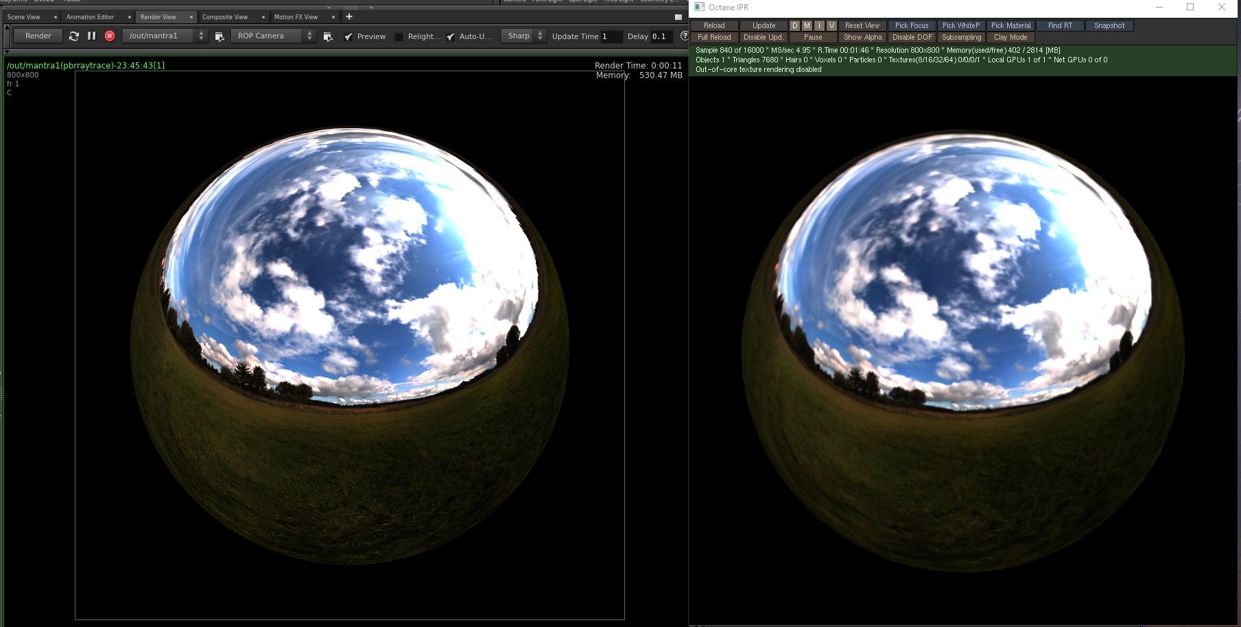

I am testing a scene here with an HDRI environment and with the correct settings, working always in the linear space, the Mantra and Octane renders looks near the same. Attached you have the scene file. You can set any HDR file in the environment light (for Mantra) and the same image in the Render Target texture environment (for Octane).

About your second question, the problem can be that you don't have the option "Surface brightness" enabled in the emission node. You should enable this option and set the power to 1 to match the input plate. Also as always be aware of the Octane tone mapping settings, film response, vignetting effect, etc.
