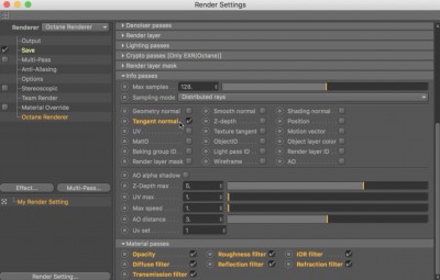

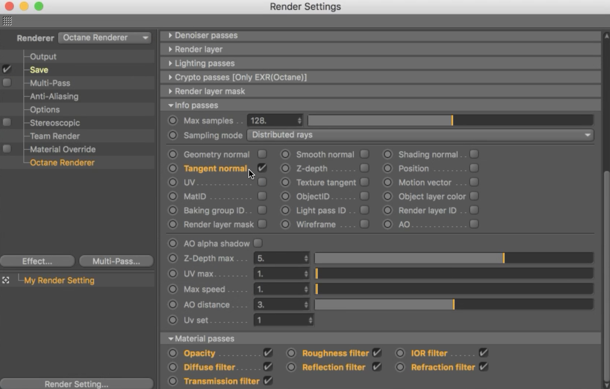

a possible solution is to use Octane Baking:
http://www.aoktar.com/octane/Baking.html
to extract the maps of these passes:
to more easily recreate a similar material with c4d standard render.
