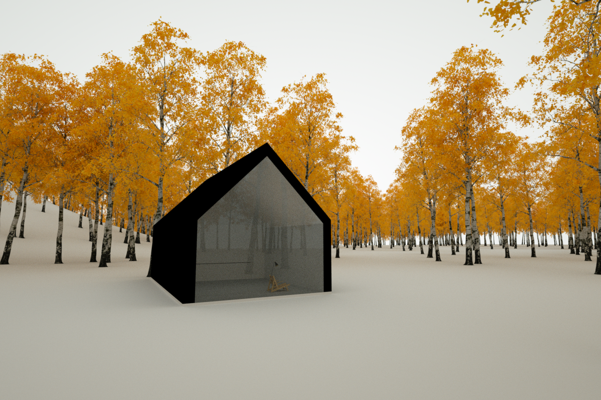

i'm trying to achieve a glassmaterial that looks like the one used in Peter Guthrie's illustration (attached).
i have tried all the glass materials from the livedb, but none of them has the fine reflections as Peters has.
it be caused by my settings - i use PT.
tips to improvements are very welcome :-)

As a starting point you can use a Specular Material with Fake Shadows enabled, and other than that use the default settings. This assumes the glass in your 3D model is double-sided. Then, how that glass looks will depend mostly on the environment and the geometry around the hut.
