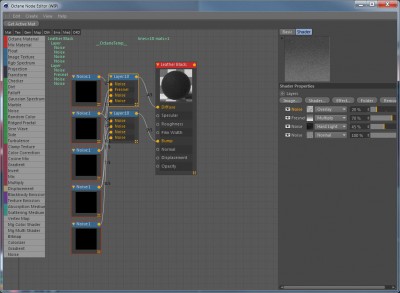

I don't have exact idea about your CUDA errors. But DO NOT build materials like this. Use octane shaders or images not LAYER texture.
First this is horrible way to slow down you. It takes lot of cpu time to pre-render to images on opengl/material previews + on sending to renderer.
Second, this LAYER textures are causing crashes on render outputs.

Hi aoktar.
Thanks for this hint.
i bought a Material pack from pixel lab and tihs one was part of it.
Good to know the right way anyway.

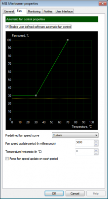

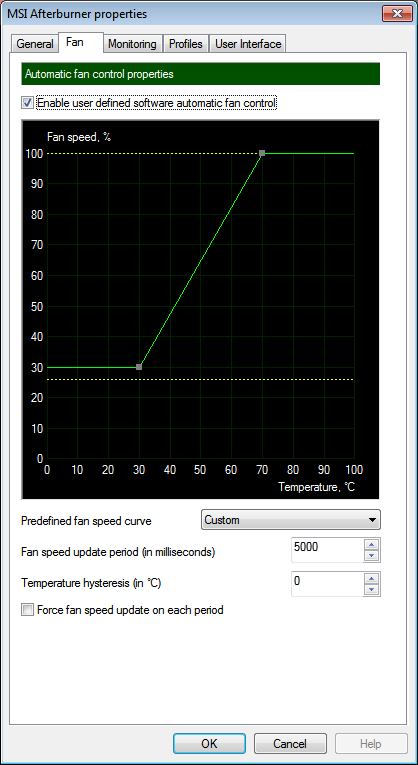

One thing I always do is run MSI Afterburner to make sure that the GPU is cooled properly. Personally I find the default fan settings a bit too hot, which is why I'm setting the curve to 30% at 30deg and 100% at 70deg:
Worth a try but I'm not sure if that would help you in your particular case.
Could you also check whether disable post-processing makes any difference? Thanks.

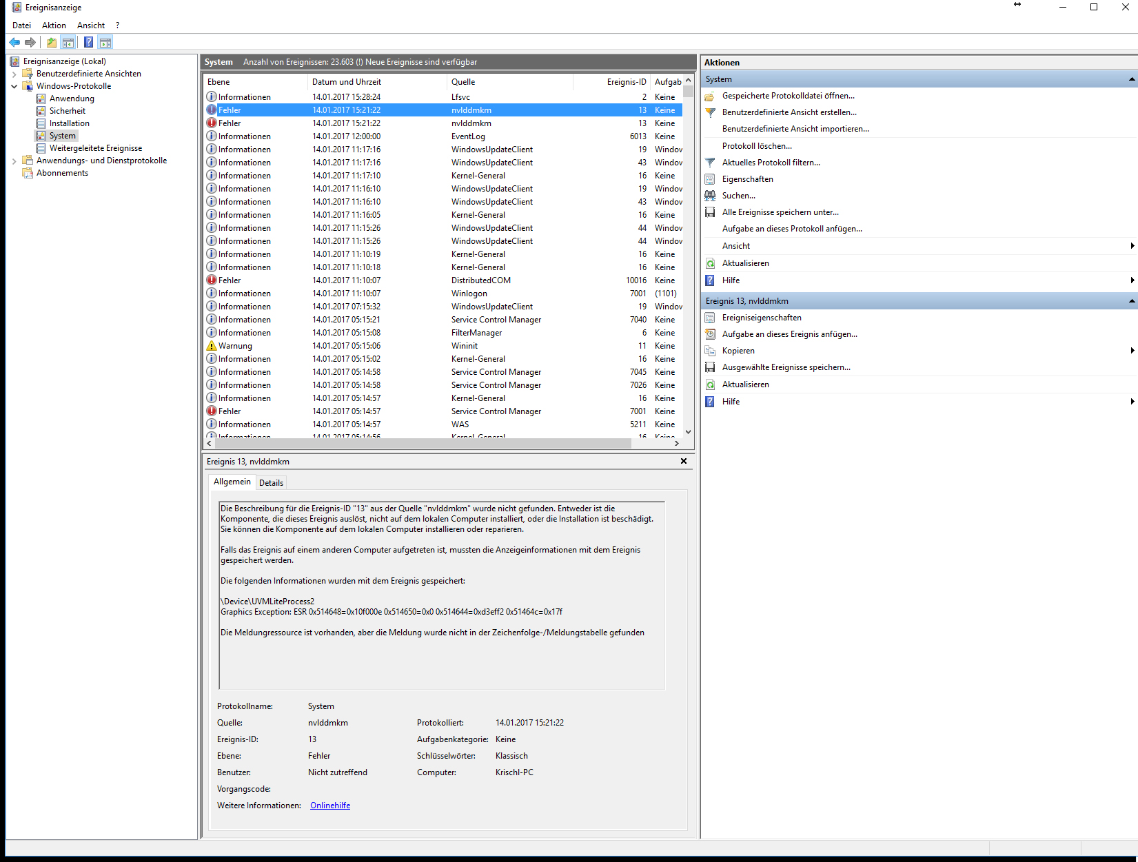

but yesterday i saw in the Event Display from windows that the nvidia driver was crashed.
so i did a reset on the MSI After Burner to default settings.
and it works.
i was able to render the whole mercdess scene without problem.
i tried also a bit of a long term test, im currently working on a really havy scene and i was able to render this scene for 13 hours without any error.
so i think , in my case the problem was a combonation from an old bios version and overclocking.
